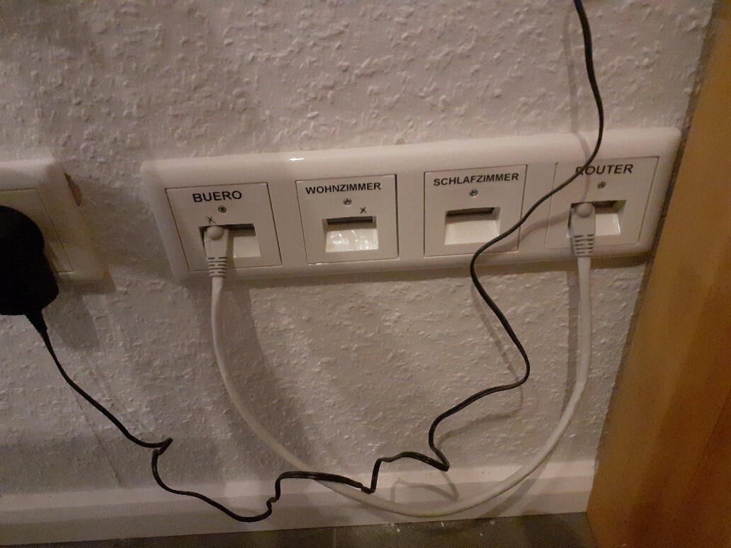

In our new build, the router was originally planned to be placed in the hallway, and the necessary connections were installed accordingly; see attachment. When I tried to connect the router, I was told, "That won’t work because there is no fiber optic connection here." So the router was installed in the utility room at the phone socket. From there, a cable runs to the hallway. Currently, this setup creates a kind of “messy connection” between the router and the office. We can switch it so the connection is between the router and the living room. I would like to have a second cable so that both the office and the living room have LAN access. The electrician isn’t sure if he has such a cable available. What is it called? Then I could try to get one.
Heidi196526 Oct 2021 22:03Do both orange cables need to be connected to the router now? Or why are there two cables?
Grobmutant26 Oct 2021 22:10I still don’t quite understand the wiring you have there.
Where do the orange cables lead to?
But a cable that isn’t connected on one end is pointless, so it probably won’t hurt to connect it to the router as well.
Heidi196526 Oct 2021 22:30I understand that the orange cables run from the utility room to the hallway. Each junction box in the hallway has two connection points. If I plug a patch cable into the left socket in the hallway, I should also connect the corresponding socket on the left in the respective room. I assume that the second orange cable also needs to be connected to the router. But what is the name of the adapter or connector I need to get for this? The electrician is never available, and I don’t feel like calling again to follow up.
hampshire26 Oct 2021 23:15Get yourself a switch. This device handles the distribution function. Using a patch cable (your "monkey swing cable"), connect from the router outlet to the switch, and from the switch, you can supply each room with its own patch cable. The connection points for distribution are called "ports." You can get a switch like this, for example, with 8 ports from TP-Link for about €20.

RotorMotor27 Oct 2021 22:05It could also be that only one Cat (the orange one) is connected to the double socket. Just give it a try. ;-)
