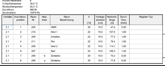

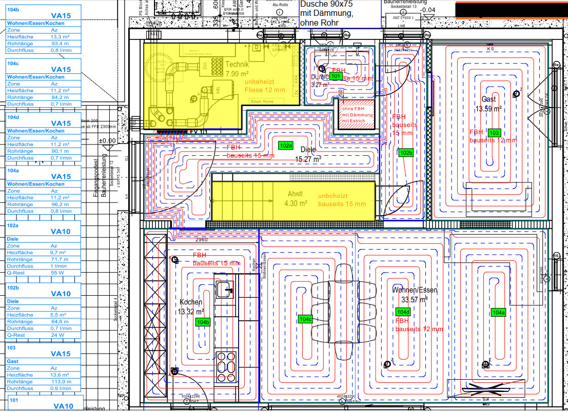

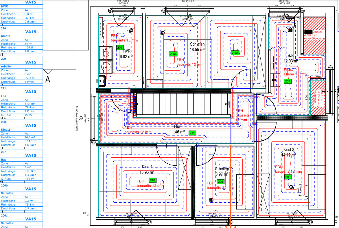

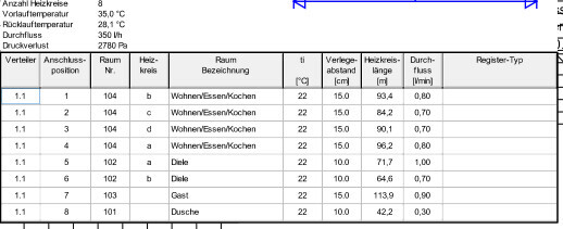

SandyBlack20 Jan 2024 11:13I’m happy to share the plans. As mentioned, I am aware that the design is not optimal.
The technical room and storage areas should actually be heated as well, but our general contractor simply doesn’t do that.
At least we managed to convince him to install underfloor heating beneath the bathtub.
As I said, my main concern now is about cooling and whether this setup will work.

Hausbau55EE20 Jan 2024 14:52Once again... If the underfloor heating is properly sized for heating, then cooling will not be a problem either.
Your underfloor heating design still has a lot of room for improvement. It can definitely be done better. This way, you will only get a mediocre underfloor heating and cooling system.

Underfloor heating is designed for heating, not cooling. However, closer pipe spacing is naturally better for cooling as well. The "construction" shown in the plans seems to me like a ridiculous stunt or a prank close to the Flat Earth Theory *LOL*
I would never, ever, under any circumstances think of using two separate systems/piping networks to regulate ONE parameter!!! (In that sense, the idea of two different pipe spacings seems twisted and as an overlay system can only be designed by dedicated M.C. Escher experts, as a perfect and alarming example of a Pisa test failure). Kelvin and his peers must be spinning in their graves at the thought of such concepts. @Nordlys is sorely missed here!
SandyBlack20 Jan 2024 15:09What do you think are the disastrous consequences of the design? Besides the higher supply temperature and resulting lower efficiency?
@Hausbau55EE As I said, I am aware of that. It is nowhere near Flow30. However, investment costs must also be factored into the calculation. A heating system that is 10% more efficient doesn’t benefit me if it causes additional installation costs in the mid four-digit range.
