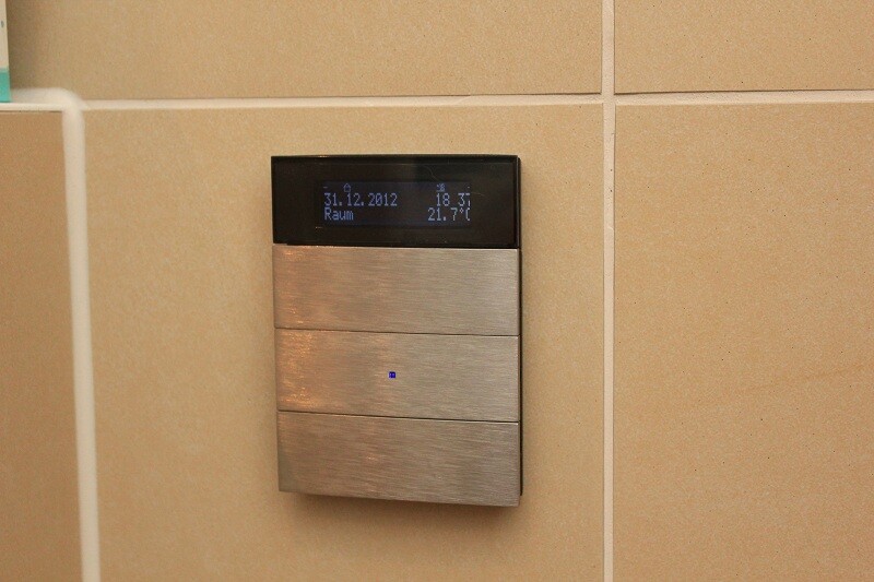

- 8 switches with displays, each with 3 rocker switches (6 buttons)

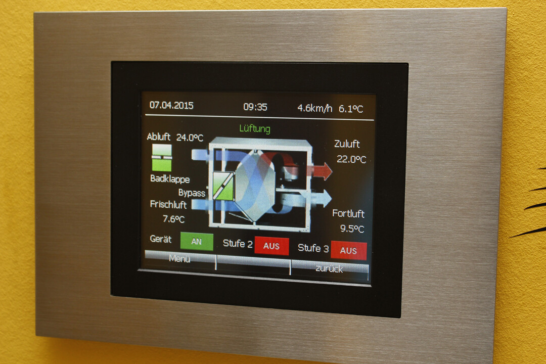

Shading, climate, ventilation, and heating control
To prevent overheating in summer while maximizing solar energy gain, these systems need to work together.

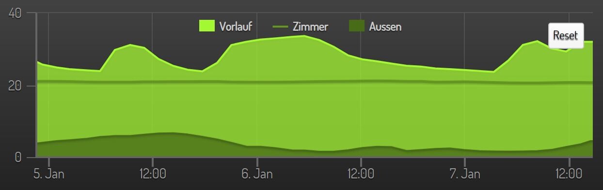

The heating system detects through indoor temperature sensors that heating is not currently necessary and circulates water in the floor to slightly maintain temperature because the weather station reports a warm day. Indoor and outdoor temperature sensors observe the difference and adjust the ventilation system to ensure air exchange but only dynamically suck in a minimum of warm outside air. The ventilation system detects air pollutants (e.g., from cooking) and filters odors as quickly as possible, deciding autonomously what action to take.
The shading system continuously adjusts the roller shutter slats to minimize heat gain without darkening rooms excessively to avoid disturbing residents. The weather station reports the current solar intensity on the sun-facing facades. As a last measure, the air conditioning is on standby and cools the rooms if thermostats signal a need. The air conditioning turns off when windows or doors remain open for extended periods. Hot water is heated and stored by solar panels.
When away or taking a nap, the house maximizes shading/darkening and minimizes ventilation. Other systems remain unaffected and maintain temperature and other conditions at the desired level. Presence, absence, and sleep are detected by additional sensors and reported to the systems.
In winter, everything works the opposite way. There is little shading to capture as much as possible of the sun’s “free energy.” Ventilation is continuously adjusted to current conditions. Windows generally remain closed. The air conditioning and summer bypass are off.
The system also detects when someone showers and increases exhaust ventilation to remove moisture quickly.
The system is calibrated enough for us to do without a separate energy recovery ventilator (ERV). Mostly, this is due to outdoor temperature-controlled boiler management and natural self-regulation rather than the advanced control itself.

- Various statistics and graphical displays of temperature trends, etc.

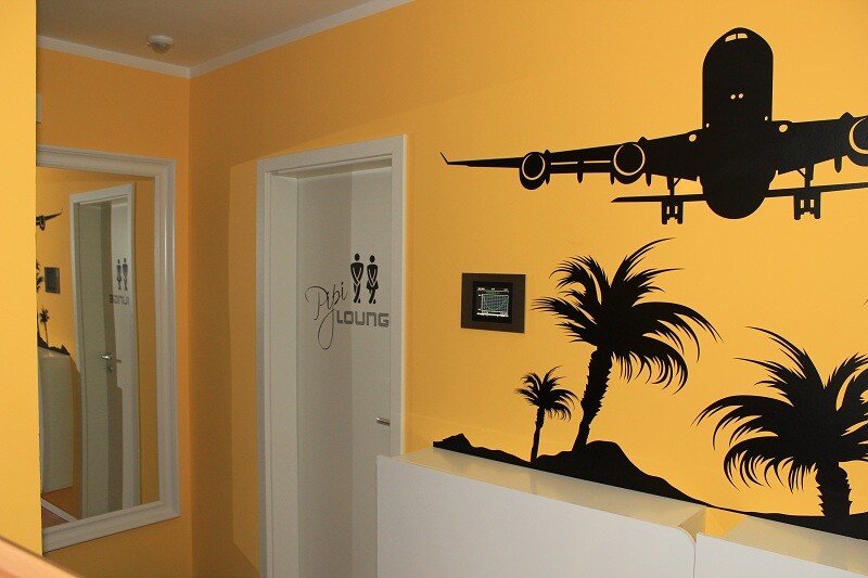

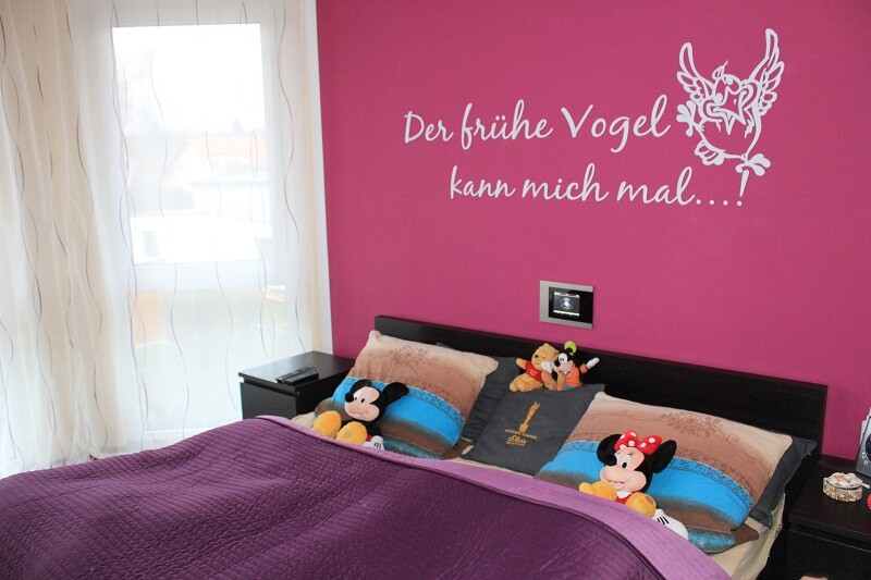

Here are a few pictures to relax:
Yellow interior with airplane wall graphic and palm trees; door with pub lounge.
Bed with purple quilt; pink wall with the saying ‘The early bird can ...’, Mickey/Minnie plush toys.
Wall-mounted brushed metal housing with display of a ventilation system (exhaust, supply)
Wall-mounted metal panel with three horizontal sections and small display (date, room).
Time course from Jan 5–7 with lead time, room and outside shown as green areas.
