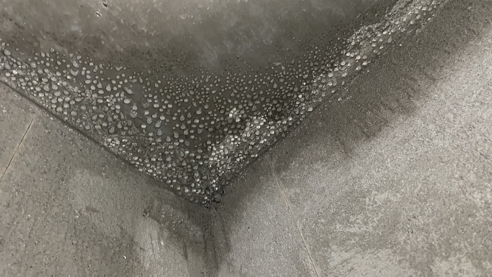

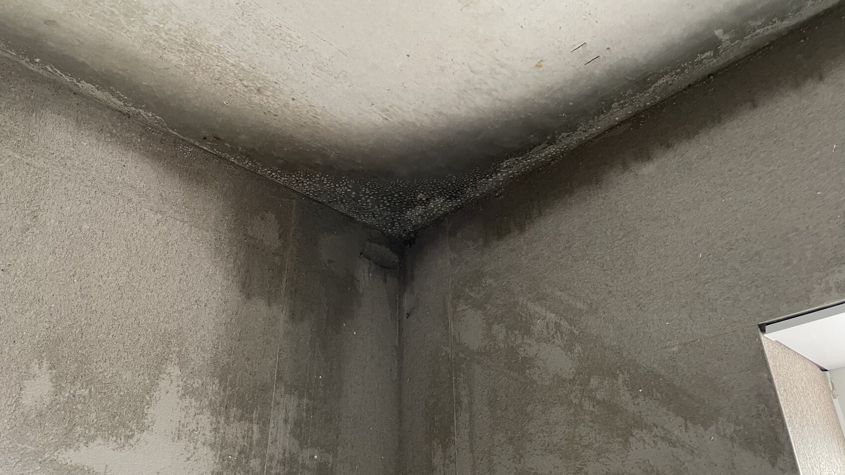

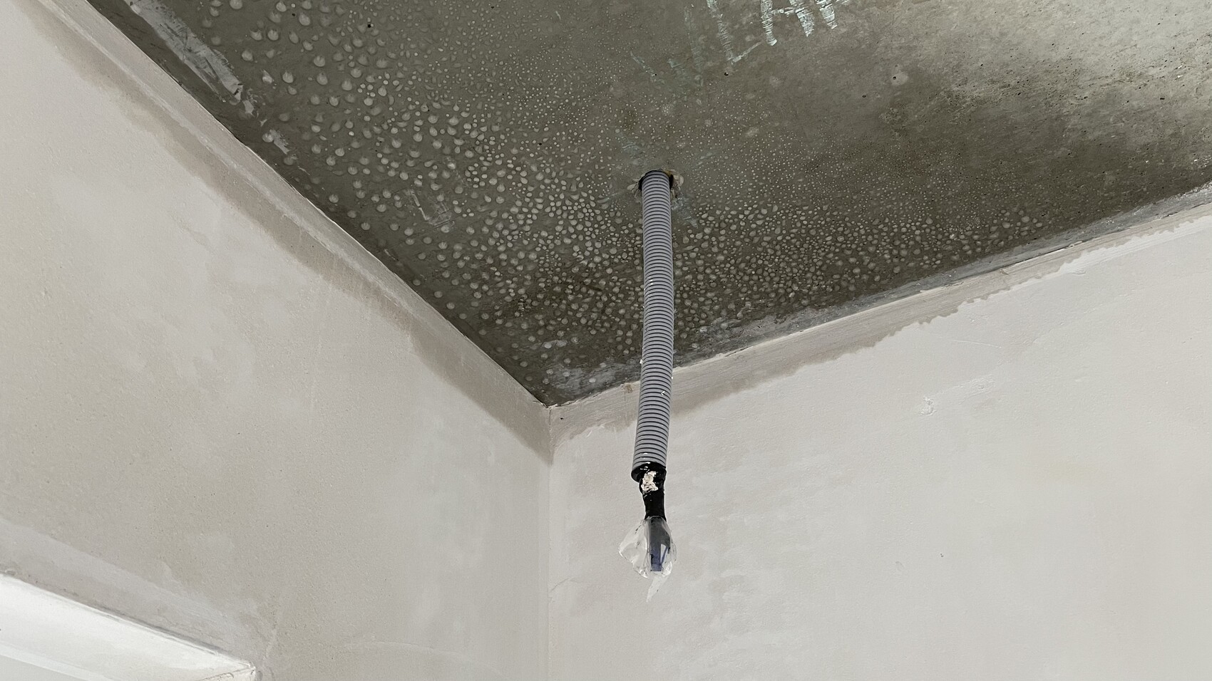

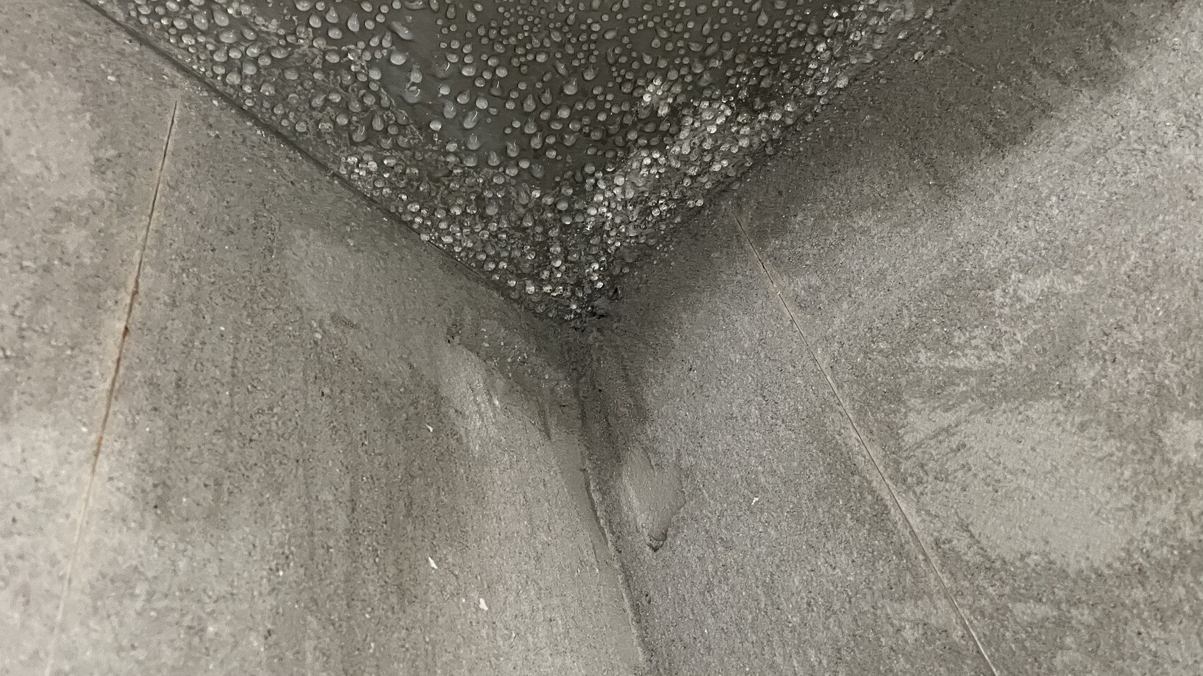

When I was at the house today, I noticed many water droplets on the ceiling exactly where the outside also shows wet spots.
I am worried that the filled concrete block might be developing mold. What do you think?

Please consult an expert, preferably from the IHK list... for a question like this, you won’t have to pay much and you will get a qualified opinion... I wouldn’t just cover it with a sheet metal without knowing what’s going on. It won’t be solved simply by adding a sheet metal...
driver55
28 Nov 2021 12:10
Oh my goodness. That looks terrible. You don’t even need a measuring device for that. Get the general contractor/site manager to the construction site right away and, as already suggested, bring in an expert.
