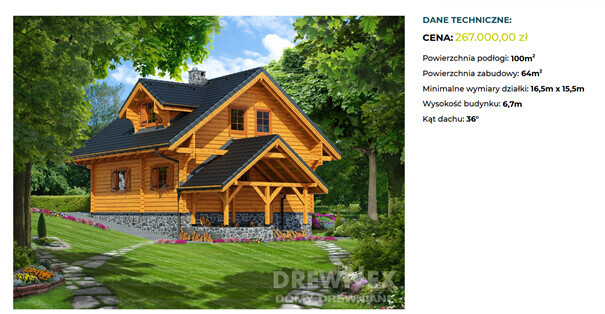

I searched a bit online. The company Drewnex builds year-round wooden houses for relatively low costs. The problem will probably be the building permit / planning permission. You might need to find an architect in Berlin who is fluent in both languages. Here is an example of such a house:
Two-story wooden house with veranda, stone foundation, and green garden.
267,000 zl = approx. 60,000 €. What additional costs might apply, I don’t know.
