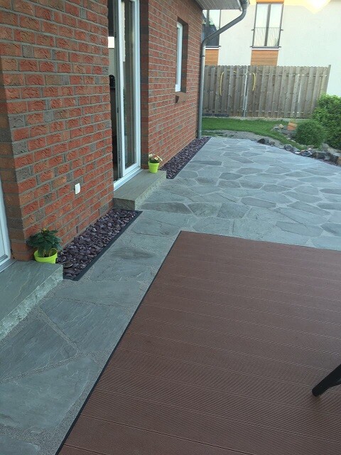

I’d like to share our terrace project from 2016/17 and, at the end, offer some conclusions about the different building materials and the manufacturers’ responses to justified complaints.
In summer 2016, we moved into our used house.
The outdoor area was in very poor condition.
So we didn’t hesitate long, and after a few drafts, it was clear that we wanted to build a completely new natural stone terrace with a roof and fence the entire garden to accommodate a robotic lawn mower.
Our local building materials supplier gave us mostly good advice when choosing the materials:

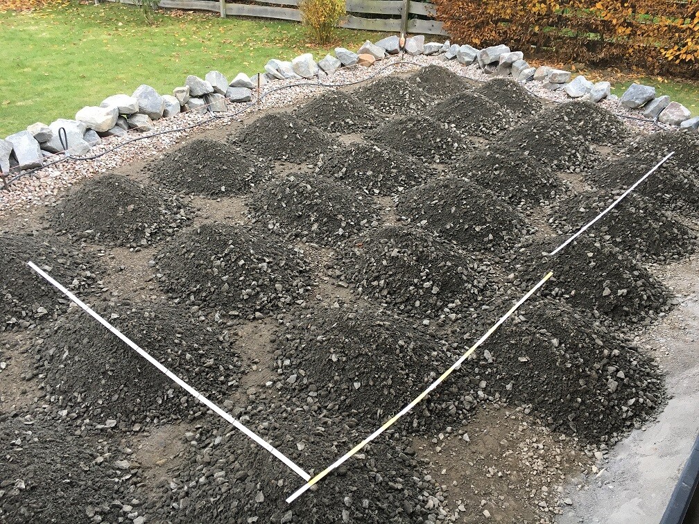

Subbase: 25 cm (10 inches) of 0-32 mm (0-1.3 inch) crushed stone (we used about 30 tons).

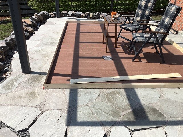

On top, a 12 m² (130 ft²) area of BiWood BPC (wood-plastic composite) full decking boards, laid on approx. 100 concrete slabs.
Surrounding that, 35 mm (1.4 inches) thick Nandi polygonal stone slabs, freshly laid into a 60 mm (2.4 inches) thick layer of trass drainage mortar.
For joint mortar, we were recommended WeberMix 682. More about this later.
Because neither a splash guard nor insulation was installed on the house’s ground slab, we took care of these during the construction phase in that area.
Around the terrace, we built a dry-stone natural stone wall on a gravel foundation 40 cm (16 inches) deep.
About half of it is covered by a terrace roof installed by a local specialist company.
Now we're enjoying a 40 m² (430 ft²) terrace, partially covered. Next, we plan to protect the weather-exposed sides with zip roller blinds and add an outdoor fireplace stove… but for now, after 1.5 years, a new open-plan kitchen with a panoramic fireplace is next on the list.

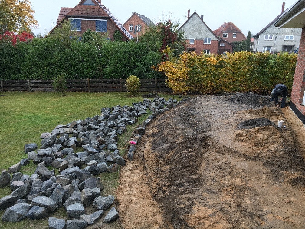

The demolition of the old terrace, including excavation for the crushed stone and stone wall, took about two weeks until everything that needed to go was removed.
Once around 10 tons of quartzite rubble were piled in our driveway, the real puzzle began. Building a dry stone wall requires a lot of patience. Meanwhile, the substructure was layered step-by-step. Two large block steps made from the same natural stone as the polygonal slabs complete the overall look. After a month, the new base was ready.

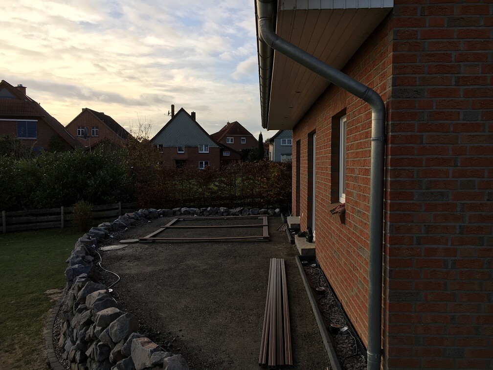

Back to the terrace: next was determining the area for the BPC. We laid a ring of polygonal slabs around the footprint to find the ideal position.
Then about 100 concrete slabs had to be leveled and fixed in place as the base structure.

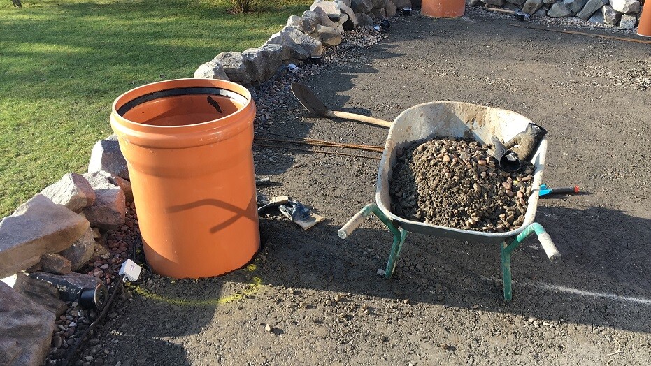

Quickly, we installed two foundations for the roof (50 mm (2 inches) PVC pipes, 80 cm (31 inches) deep, reinforced with four 2 m (6.5 feet) long rebar rods, then concreted).

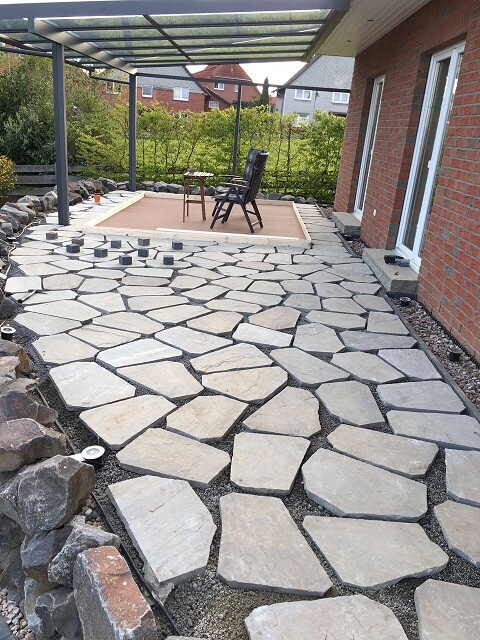

Next, we spent about two days sorting and laying out the polygonal slabs. Given their size (approx. 60 cm (24 inches)), this was essential; otherwise, the result would not have been satisfactory. After positioning all slabs, we marked and photographed several corners.
Then row by row (starting around the BPC), we laid the slabs “fresh in fresh” using about 100 sacks of trass drainage mortar and 2 sacks of WeberXerm 854 flexible natural stone adhesive. From that point, the result looked impressively good.

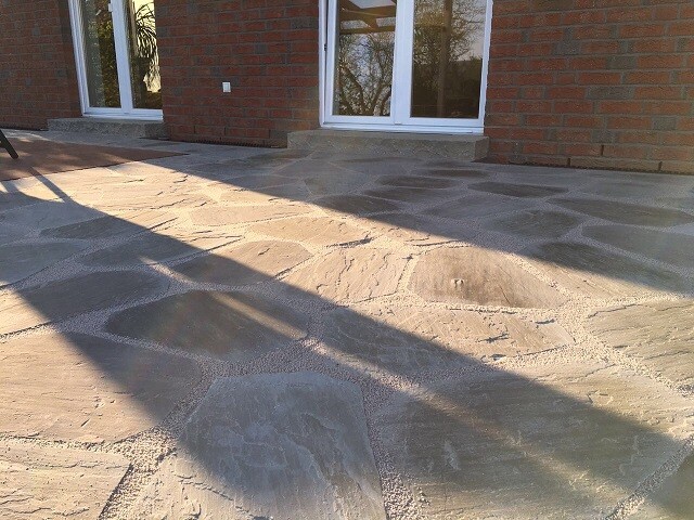

After the terrace and garden were finished and heavily used that summer, we noticed we were constantly tracking sand into the house. At first, we didn’t think much of it and simply washed and swept the terrace.
But it didn’t improve. We started paying closer attention to the sand formation and swept everything up. It filled a full shovel!
Concerned, we performed abrasion tests in several places. We found that the material could be rubbed off with the sole of a shoe. We contacted the building materials supplier and initiated a complaint. After much back-and-forth about appointments (some clearly don’t realize you sometimes have to do work yourself), a field representative from Weber finally came.
He listened first and rubbed on the mortar. Then he started “finding hollow spots,” claiming there was water trapped under these areas and therefore it hadn’t cured properly… what an absurd explanation.

Hi, it’s frustrating what you’re dealing with here, but issues like this are quite common with polygonal slabs. I can recommend products from tubag quickmix here, as they don’t sand even if the mortar is applied a bit more fluidly. A light rain during drying will also cause some warping.
Don’t let it get you down,
