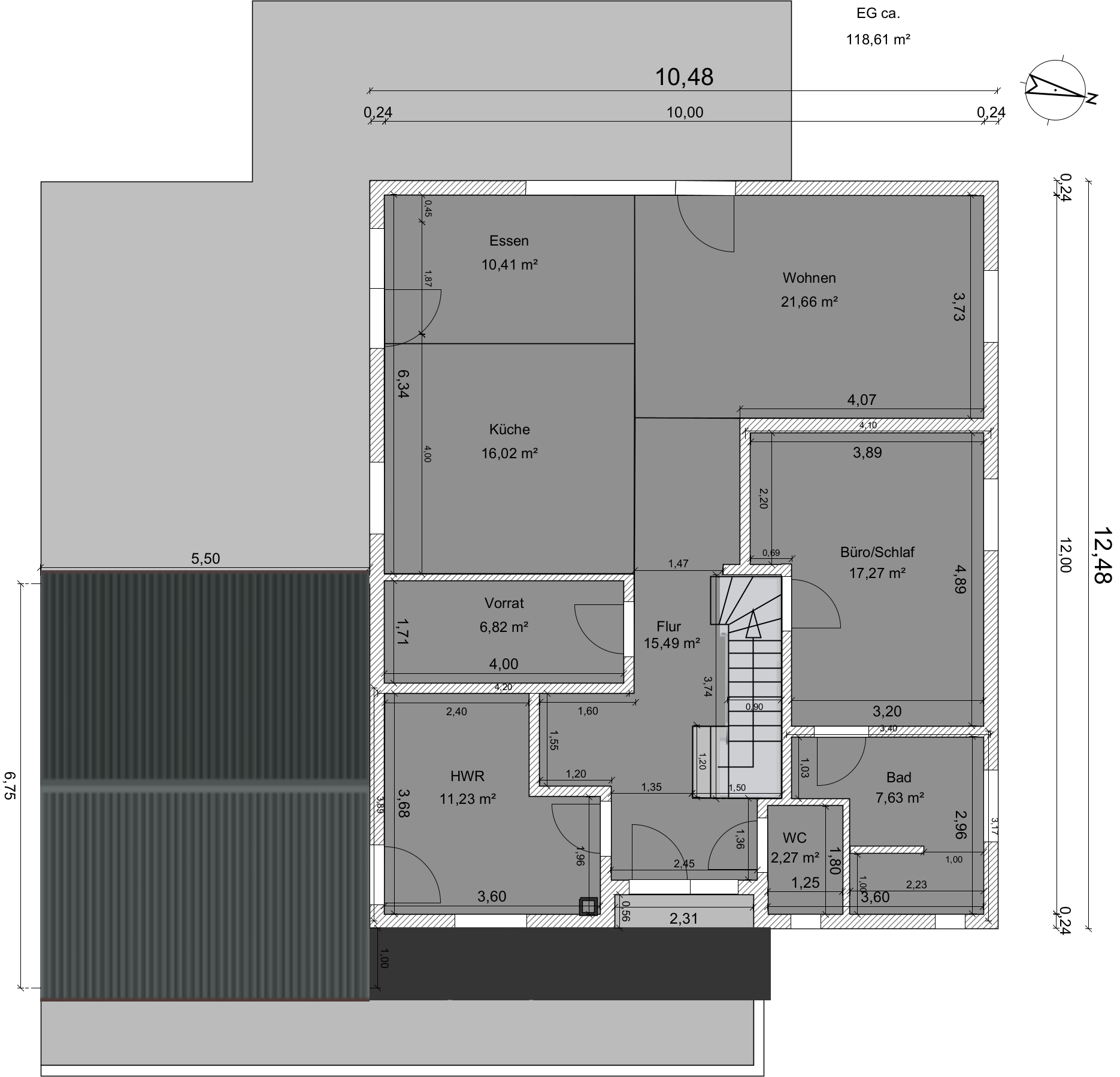

MB86Hello,
we are currently working on our initial planning attempts. Maybe some experts have a few tips that one might not usually consider. It is important to us that only the ground floor is suitable to live in when we are older. We are still quite unsure about the staircase planning.
Any criticism or other suggestions are welcome.

It also makes a difference whether you are planning with a wish for children at age 20 or already have teenagers at age 40.

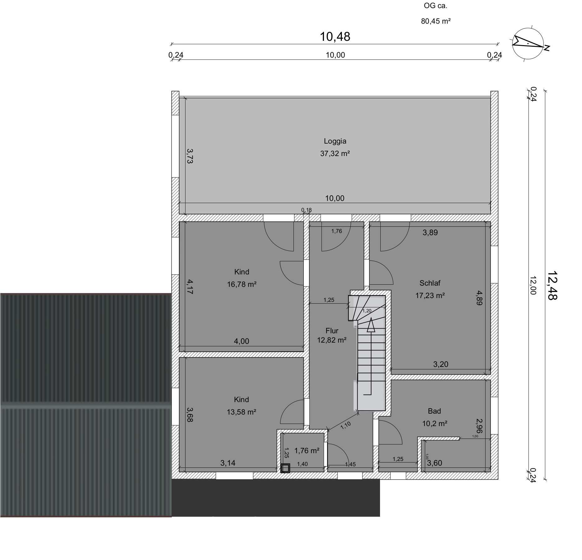

In this draft, I see a house costing about 700,000€ / 750,000€ without garage and excluding additional construction costs, with bedrooms and bathrooms that cannot be furnished simply and functionally, an outrageously expensive loggia, a living room that is too narrow, a garage door unusable with two cars, a convoluted hallway with a tripping hazard at the stairs and a cramped coat area, and a child’s room where the window is covered by the garage roof. And if this really is supposed to be a mixed stair with a landing, then it is too short and probably unsafe due to alternating tread design at the bottom and twisting stairs at the top, and the door to the office also won’t fit.

It is important to us that only the ground floor is livable in old age. And then the upper floor is used as a service apartment for a caregiver and cleaning help or something?
Nida35a schrieb:
Then look at bungalow floor plans, they are good for living in old age, with reasonable room sizes and bathrooms. Instead of the basement stairs, plan the stairs going up and have the necessary rooms upstairs. For a retirement home, you should look at retirement home floor plans. Bungalow layouts rarely have basement stairs positioned well if they also need to be good going in the other direction.
