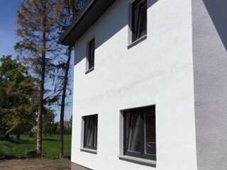

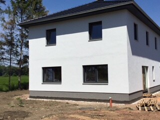

White house facade with windows next to trees on a sunny day.
Modern two-story white house with large windows, exterior view
This is what it looked like for us at the time.
