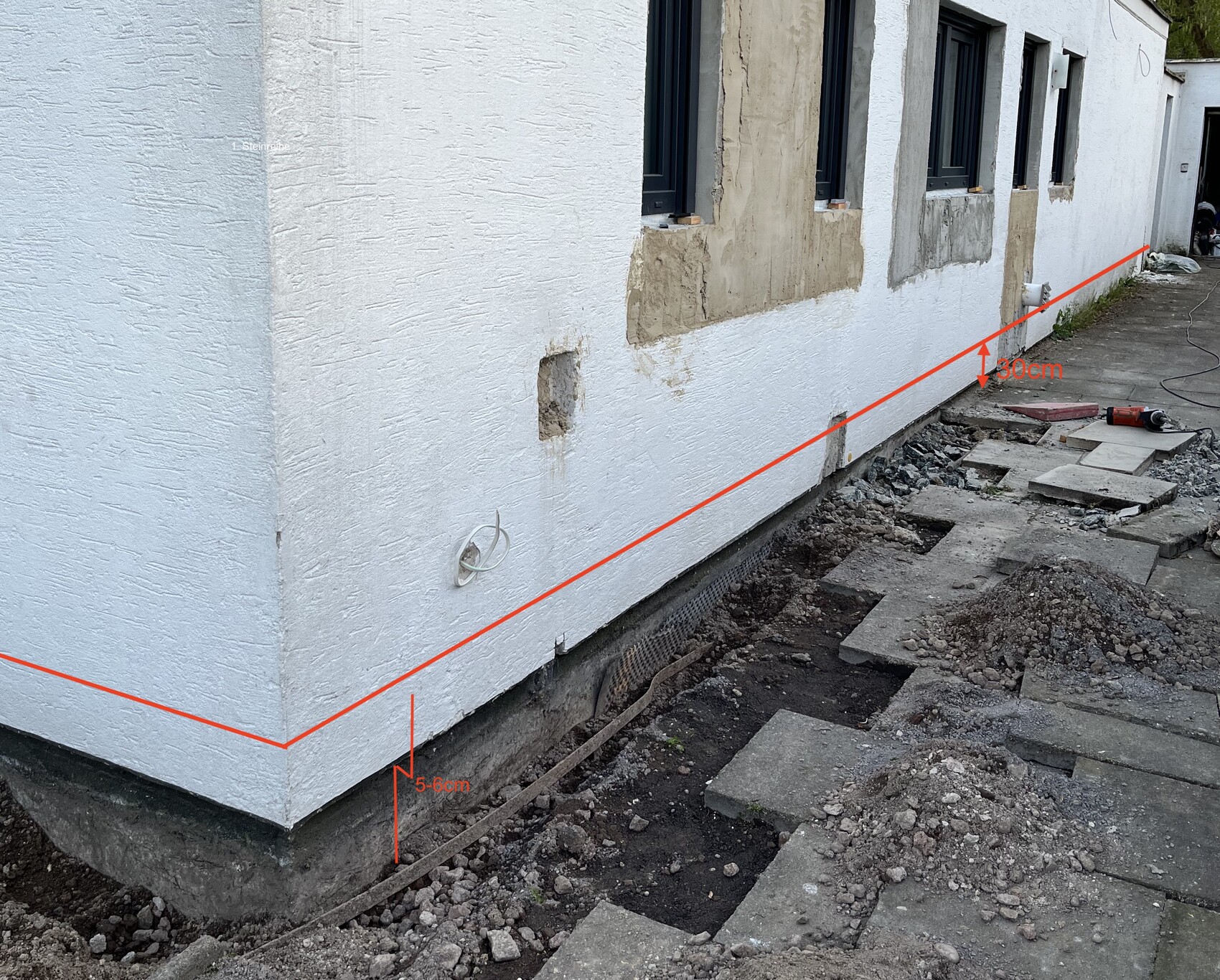

The house does not have a basement and the terrain slopes.

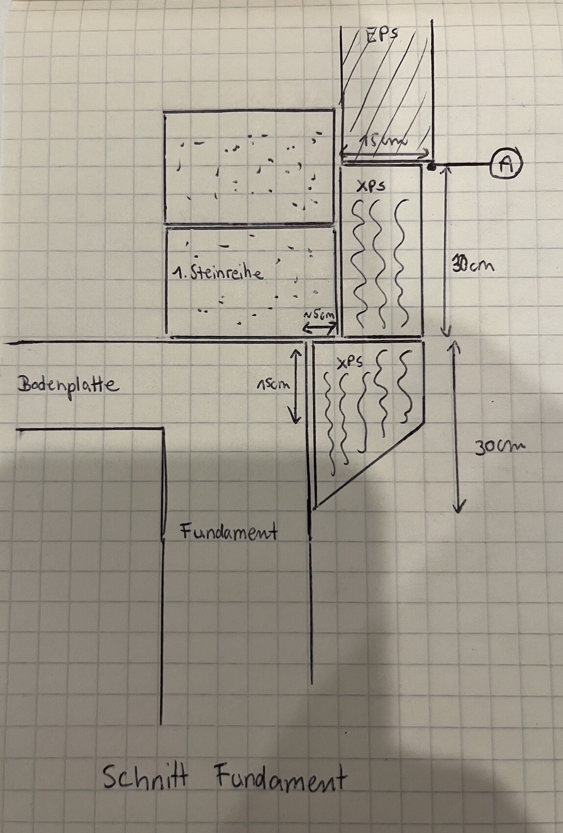

1. Would you use two XPS boards of different thicknesses, as shown in the sketch, to compensate for the projection?
2. Usually, the insulation boards at the plinth are glued with a bitumen adhesive. Can this be applied on the old render and existing paint?
3. Should there be a rail or similar element between the XPS and EPS boards, or are these just butted together?
What is not visible in the sketch are the various waterproofing layers, such as the bitumen layer, then fully bonded with bitumen and, if applicable, an outer protective layer and dimpled membrane.

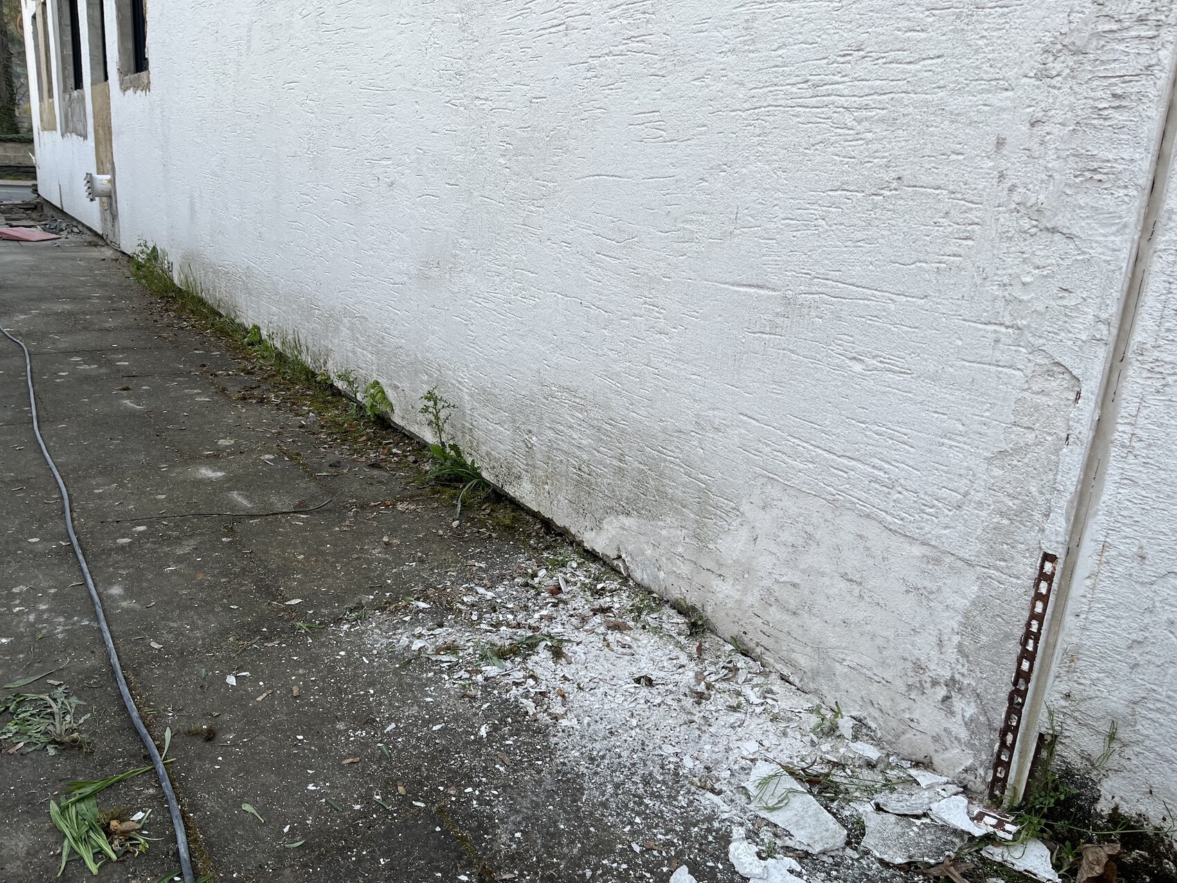

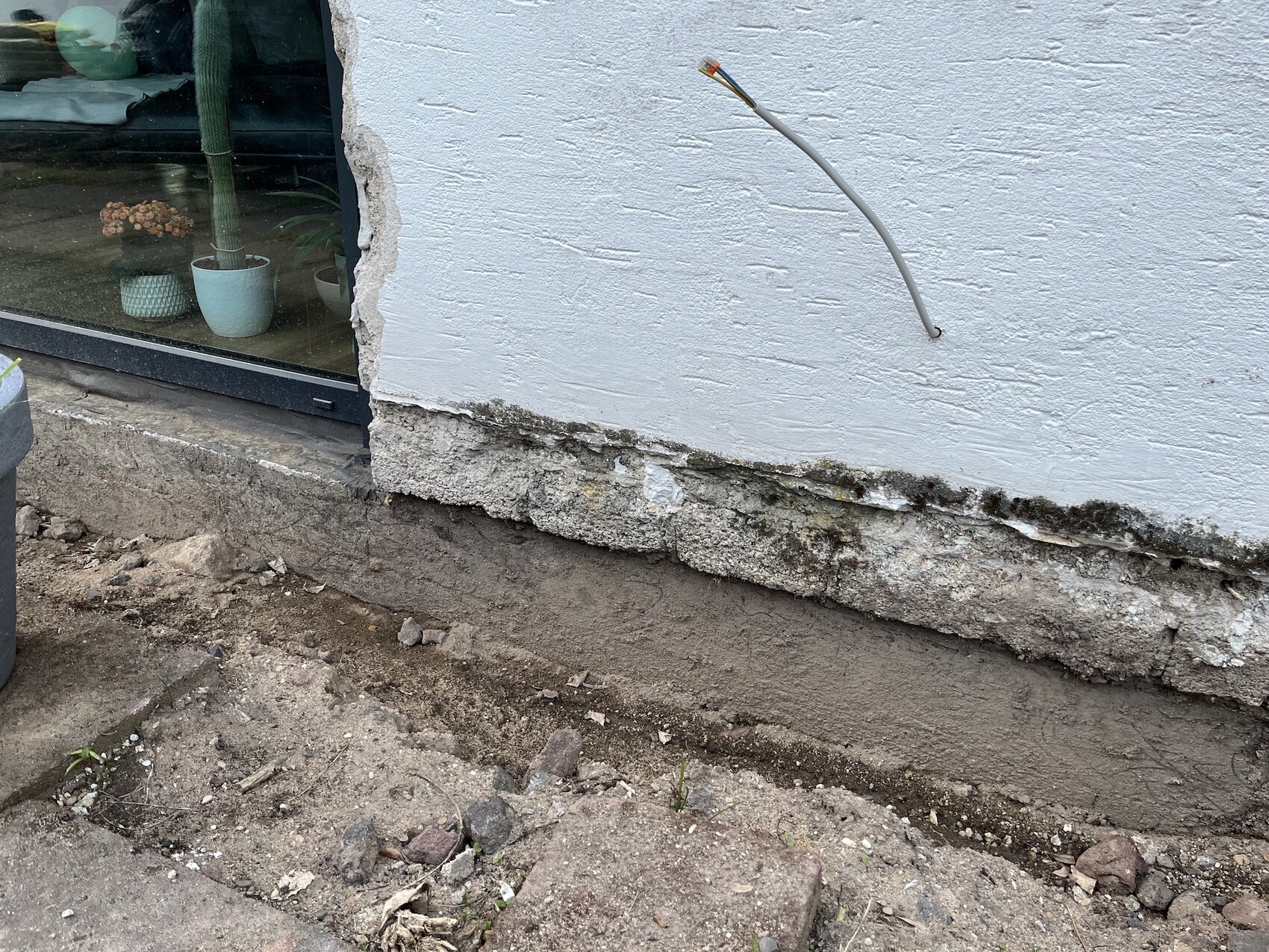

As part of my own work, I have already started digging a trench around the house and have been matching the modified and partially newly bricked window openings with plaster to the old render.
On one side of the house, there used to be a baseboard, meaning there is no plaster there. Should this be compensated for when gluing with bitumen, or should cement plaster be applied there as well?
