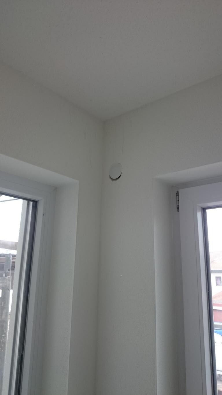

Good day.
During an inspection in spring, when it was very cold outside and the interior was heated, I noticed a kind of water stain on the wall next to the balcony door.
Above this is a roof terrace.
Now, I (and others) suspect that there is a thermal bridge here.
I reported this to the builder verbally, and their only response was “there is nothing there.”
Now that the weather is warm, the stain has naturally disappeared.
I expect it will probably reappear next winter.
I would like to note this reservation in the handover protocol.
What are your thoughts on this?
An expert can only come to the site at handover.
However, they probably won’t see anything since everything is now covered up.
It can only be measured when it is cold outside and well heated inside, which means in winter.
Thank you very much for your help.

Was it really a water stain, or perhaps just plaster that hadn’t fully dried because of a sinter layer?
A photo would have been helpful.

fraubauer13 May 2016 10:33blockhauspower schrieb:
Was it really a water stain, or perhaps just plaster that hadn’t fully dried due to a sinter layer?
A photo would have been helpful.Hello.
Attached is the photo. Not much can be seen here. The stain was more visible on site.
Regards
F
