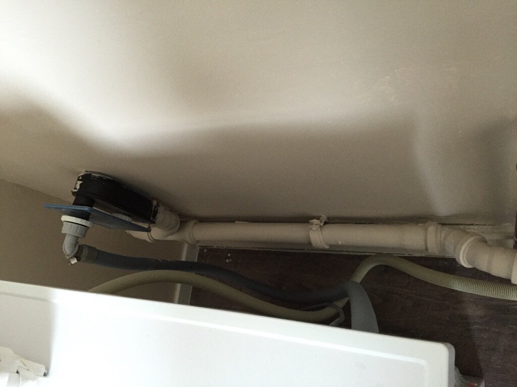

There is a surface-mounted siphon installed.

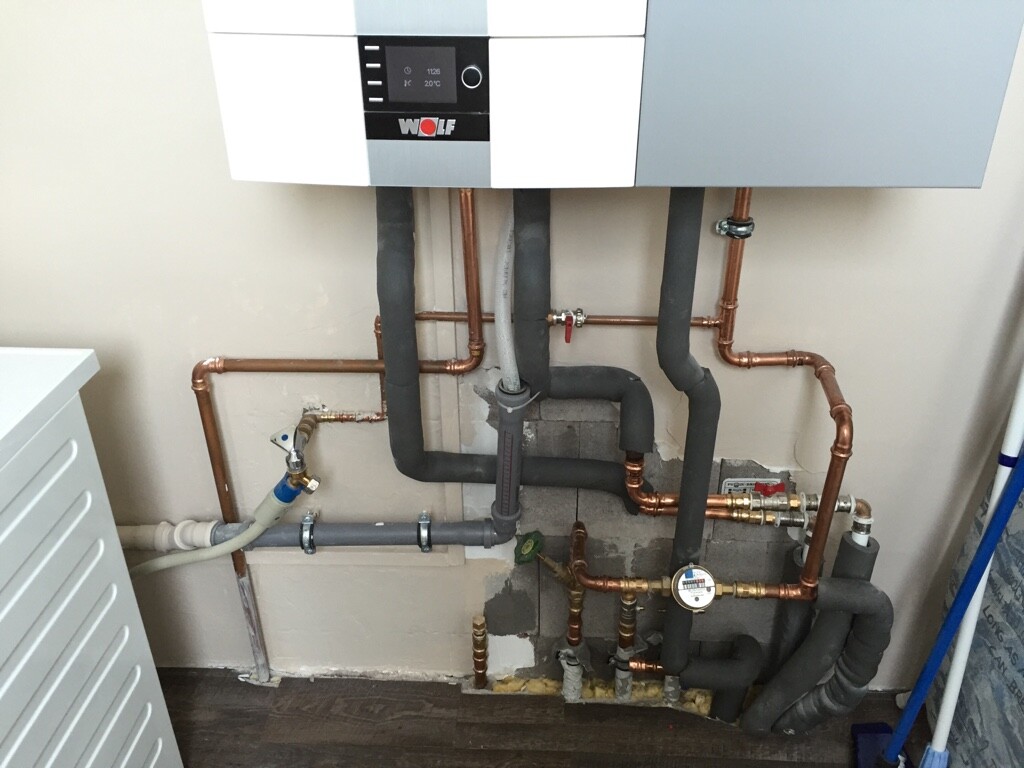

As shown in the photo, copper piping runs through the house up to my heating room in the attic.
From there, plastic pipes lead into my apartment.
There is a water meter for the other owner in the basement.

Hello
Take a look at Judo's i-Balance model. It should meet your requirements.
Besides the complicated installation, I would hesitate to have a second-year trainee handle it...,
but I also noticed:
Some insulated piping – circulation? – risk of contamination
No safety assembly on the storage tank
Olli
but I also noticed:
Olli

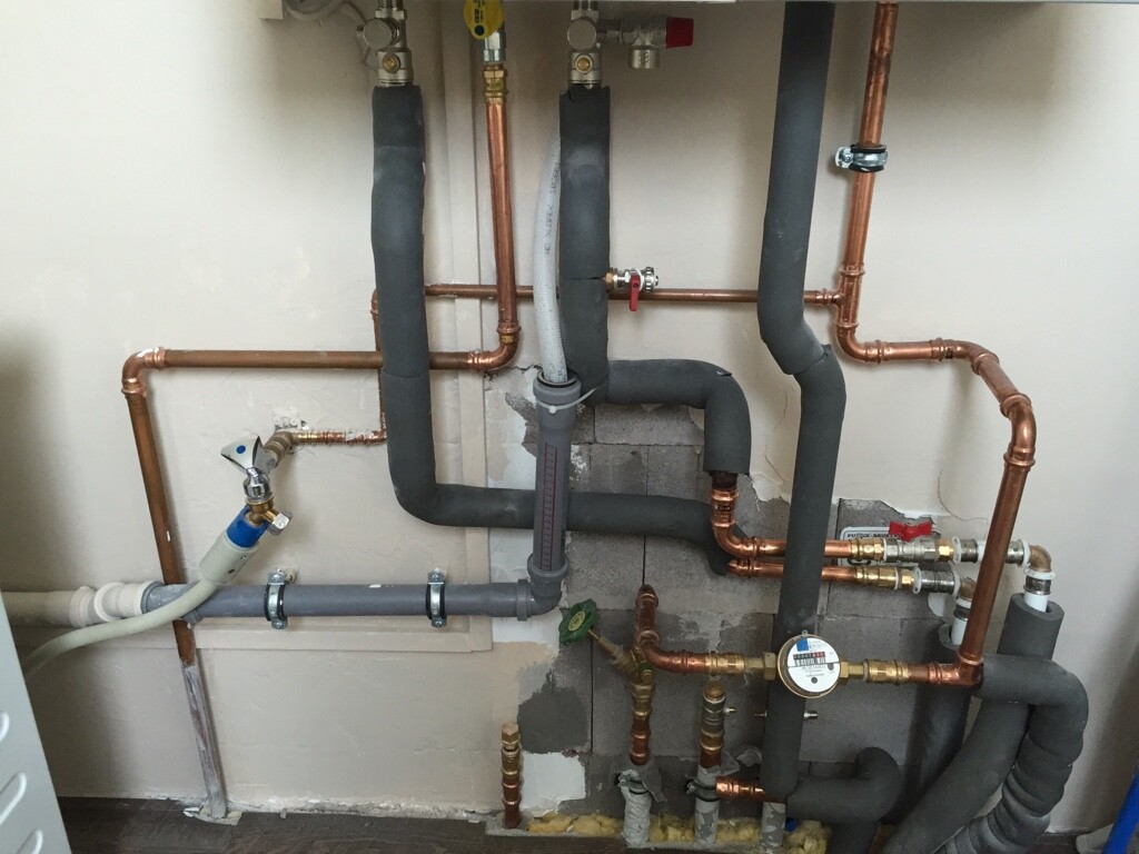

Good evening!
Thank you for your reply.
The somewhat unusual installation is due to the fact that until about three weeks ago, one boiler was supplying hot water for both parties. This means the boiler upstairs produced hot water as well as the supply and return flow for the underfloor heating for the neighbors downstairs.
In pictures 1 and 2, you can see how it was before, with separate meters and heat meters.

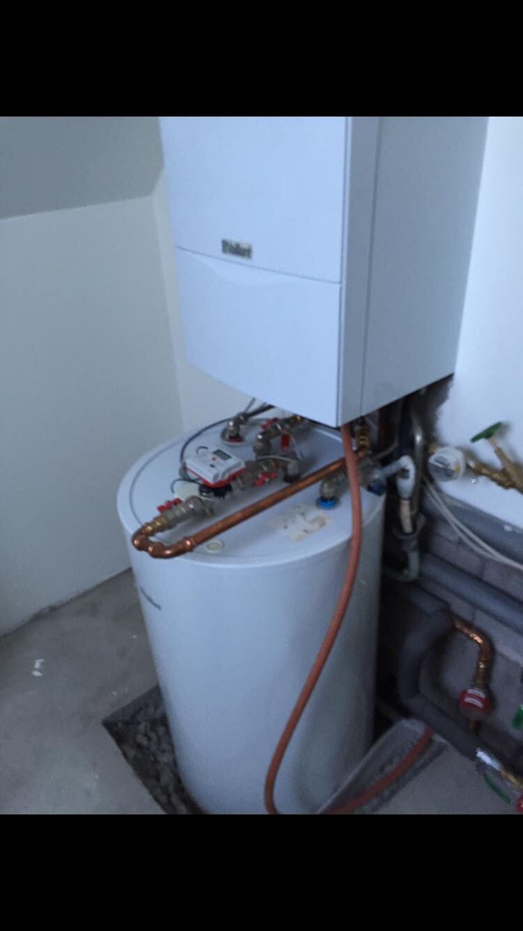

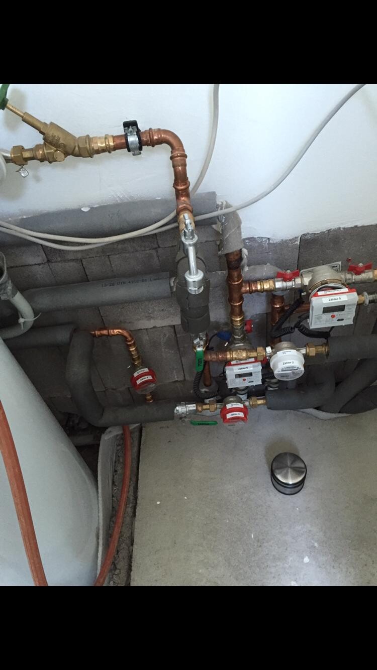

Now that each party has their own boiler, the supply and return pipes for the underfloor heating running downstairs (to the lower party) have been sealed off. So there are end plugs installed both upstairs and downstairs. The same applies to the hot water lines, since the neighbors downstairs have their own boiler now (see photos; theirs has been moved downstairs).
Unfortunately, we do not have a circulation line.

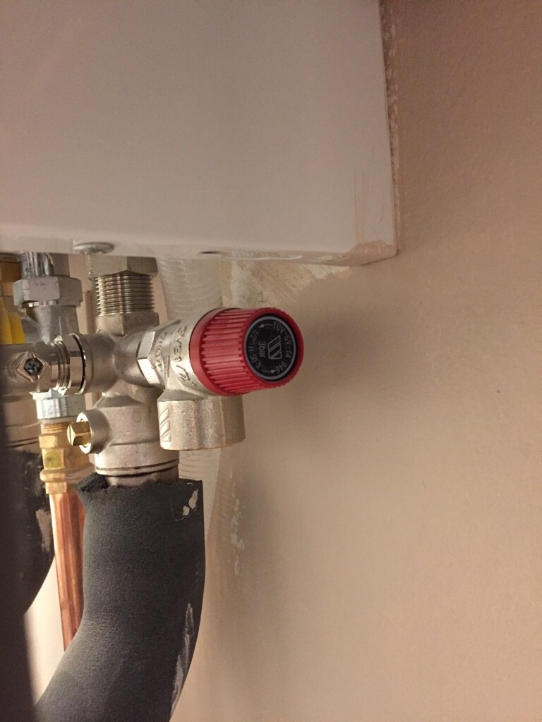

Pressure relief valve?
What is it needed for? Or could it be this red valve shown in the last picture?

Hello
This is the safety valve for the heating system. A discharge pipe should also be directed to the sewer system here.
A similar valve, including a shut-off valve, check valve, and drain pipe for leak water, should also be installed on the supply line to the storage tank.
Olli
