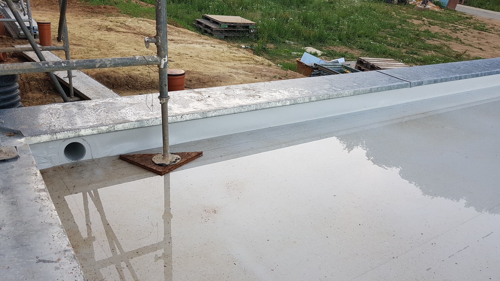

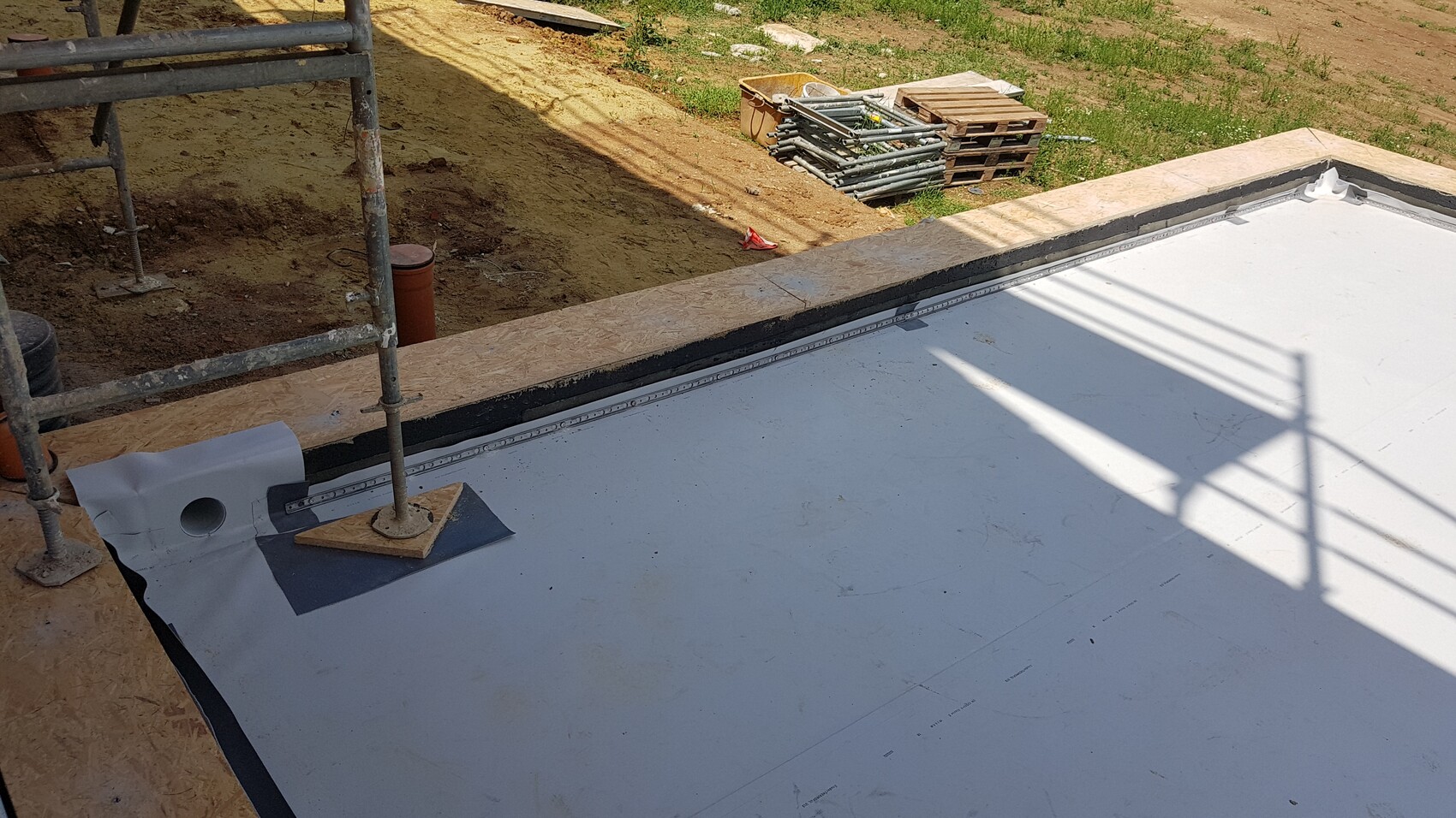

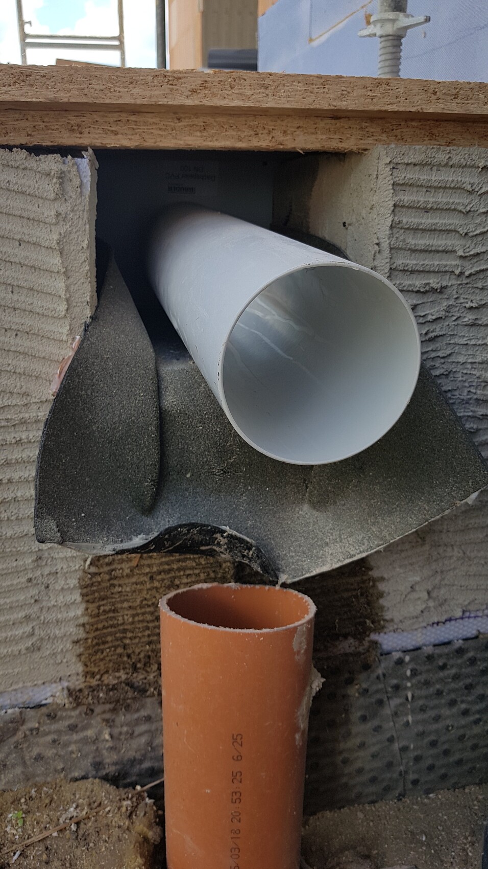

to avoid starting a new thread on the same topic, I’m bringing this one back up.
There is practically always water standing on my garage roof, as the drain is technically installed a few centimeters above the lower edge of the slope surface. The slope itself appears to be only between 0.5 and 1%, but according to the DIN standard, there are no strict requirements here—only guidelines that can be followed or not (preferably >2%, ideally 5%).
Nevertheless, I consider this problematic, not only because the seal might eventually fail, but also because during summer many mosquito larvae or other insects might breed there.
The general contractor said he spoke with the roofer, who assured him this is not an issue. They also add gravel on top, which is supposed to displace most of the water.
Well, the water still remains standing. Here is the construction process and the final result with standing water:

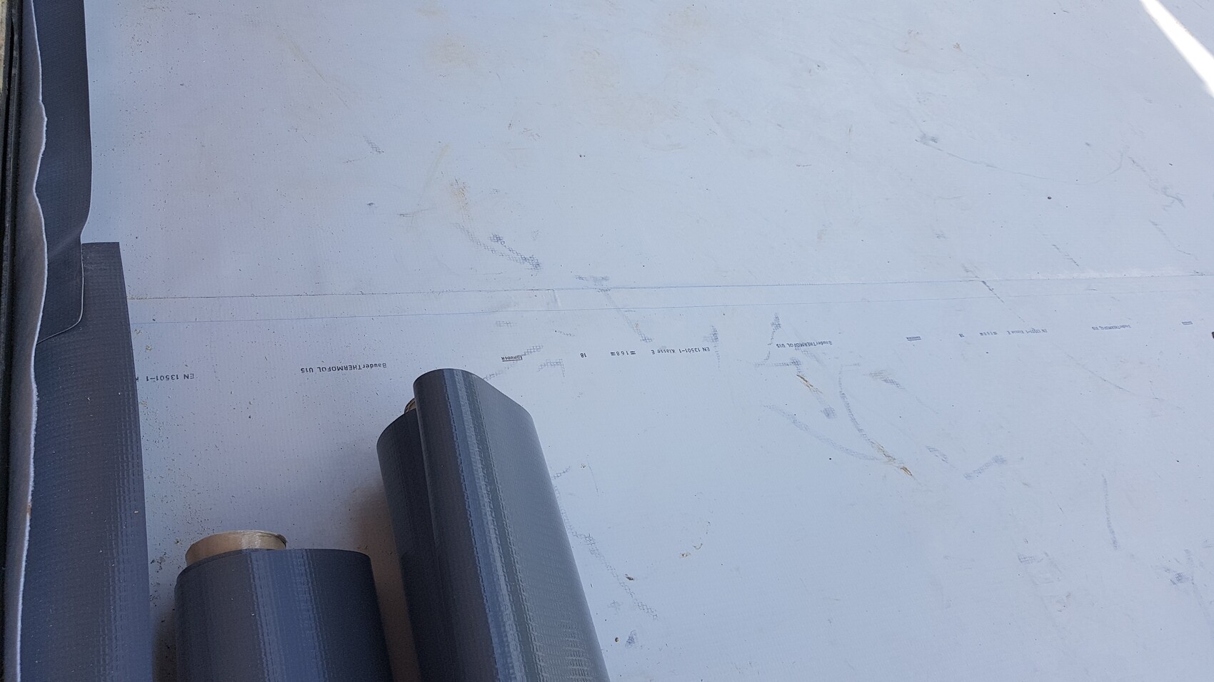

Construction site: white, flat substrate with black sealing membrane, scaffolding and pallets.
Several dark rolls of roofing membrane materials lying on a light gray surface, left side.

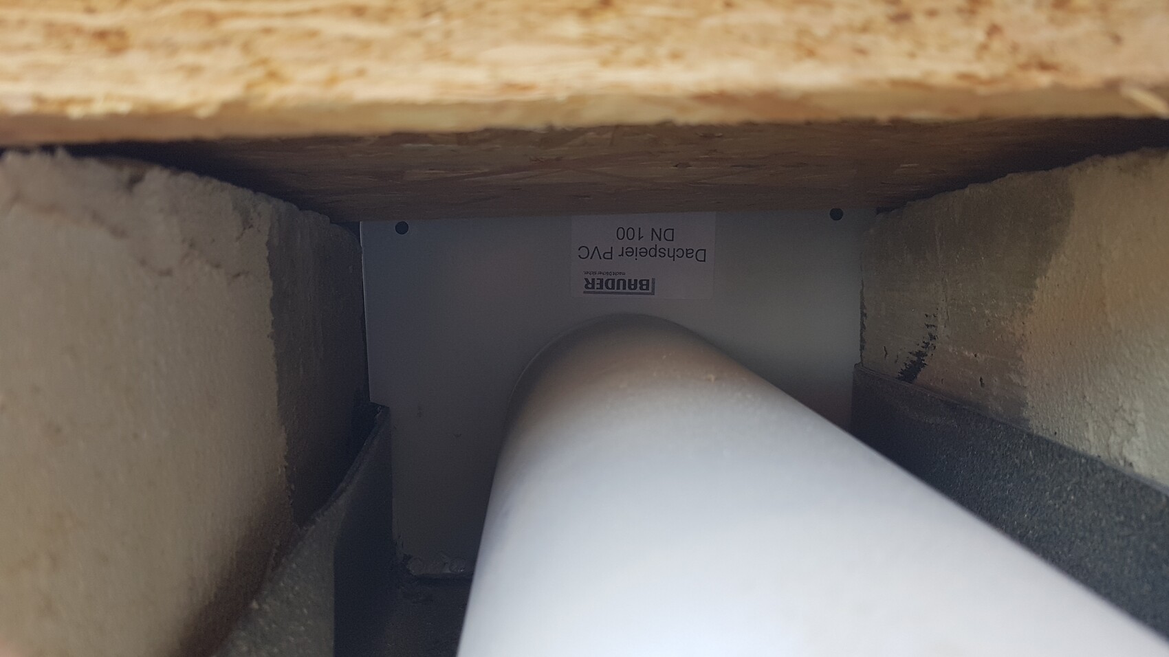

White PVC pipe running horizontally through a wall opening; orange pipe underneath.
Close interior view of a PVC elbow (90°) behind wooden panel and wall.

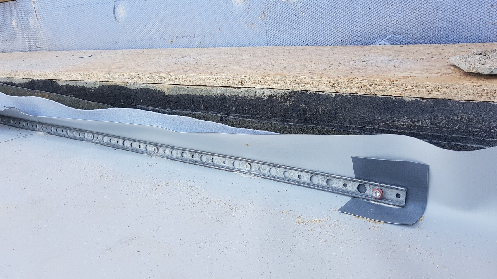

Building wall: wood, bitumen membrane, insulation, metal perforated profile.

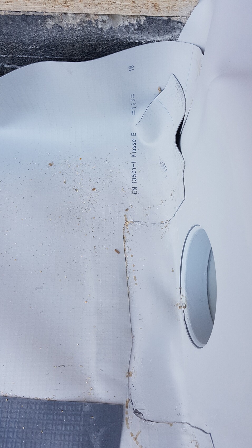

Damaged white cladding with crack and round blind panel; EN 13501-1 Class E.
Construction site: wet concrete surface with drainage opening, support pipe on wooden panel, scaffolding in background.

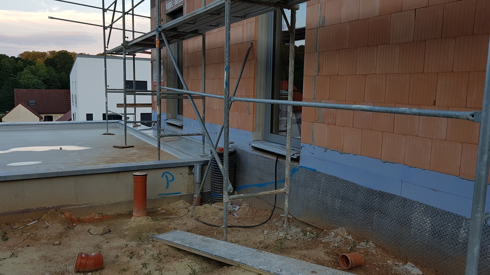

Building scaffolding in front of orange brick wall of a building, windows, earthworks and construction debris visible.
