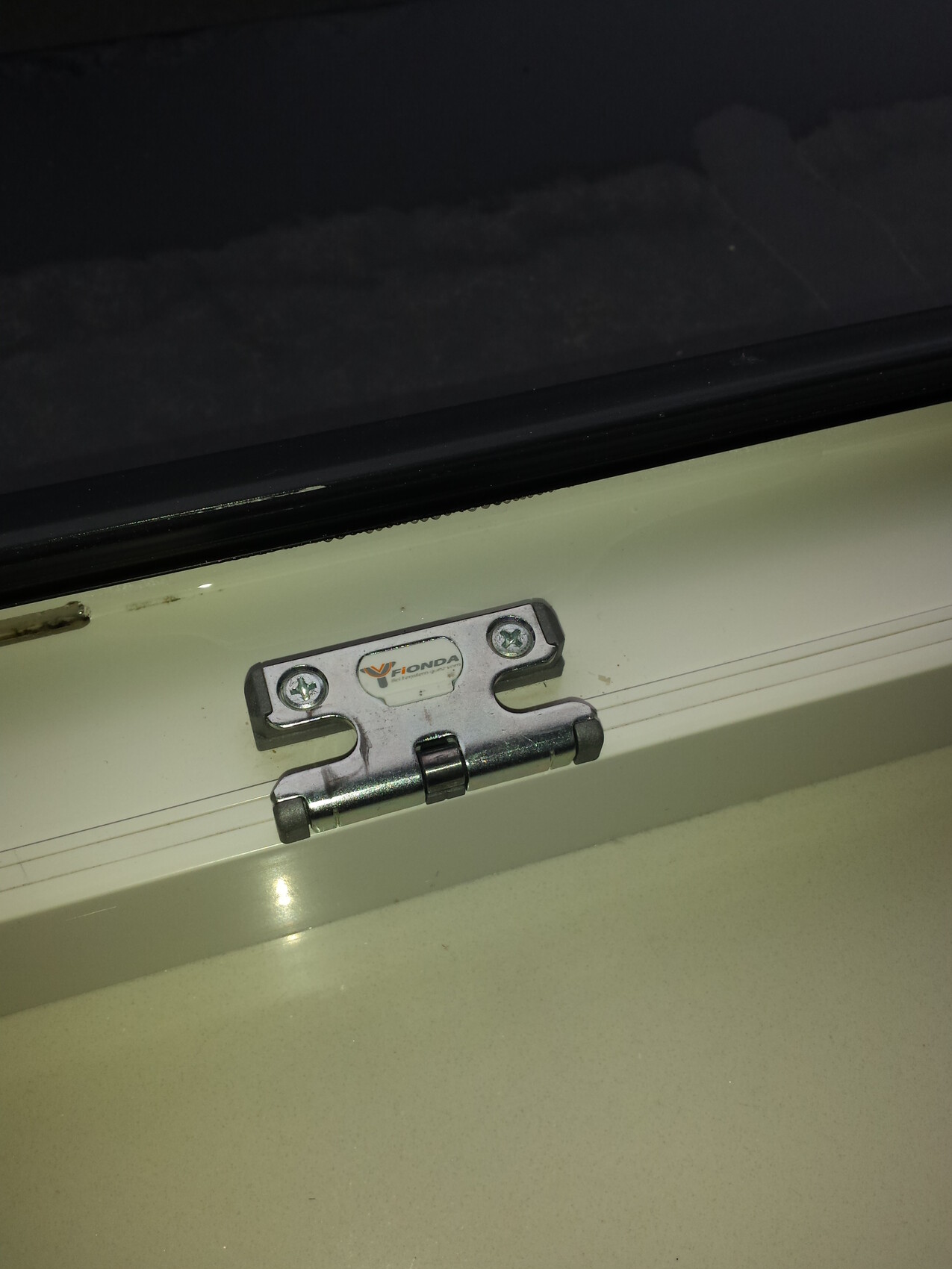

I have noticed for some time that water is accumulating in the frames of some windows; this happens with almost all windows except the floor-to-ceiling ones.
Could you maybe tell me where the water is coming from? My theory is that the windows are not completely sealed from the inside, allowing warm air to escape outside. The window installer claims they adjusted all the windows, but many windows still catch or stick to some extent.
Close-up of a window frame with a dark inner frame, white windowsill, and visible sealing joint.
Metal hinges with screw anchoring on a white door frame

In my opinion, it comes from outside. The drainage openings in the frame are clearly visible in the photos. To my knowledge, these water accumulations are normal; we also experience them after heavy rain (driving rain).

The question, however, is how the water gets in there. If it were due to heavy rain, the seal would not be properly seated against the frame.
