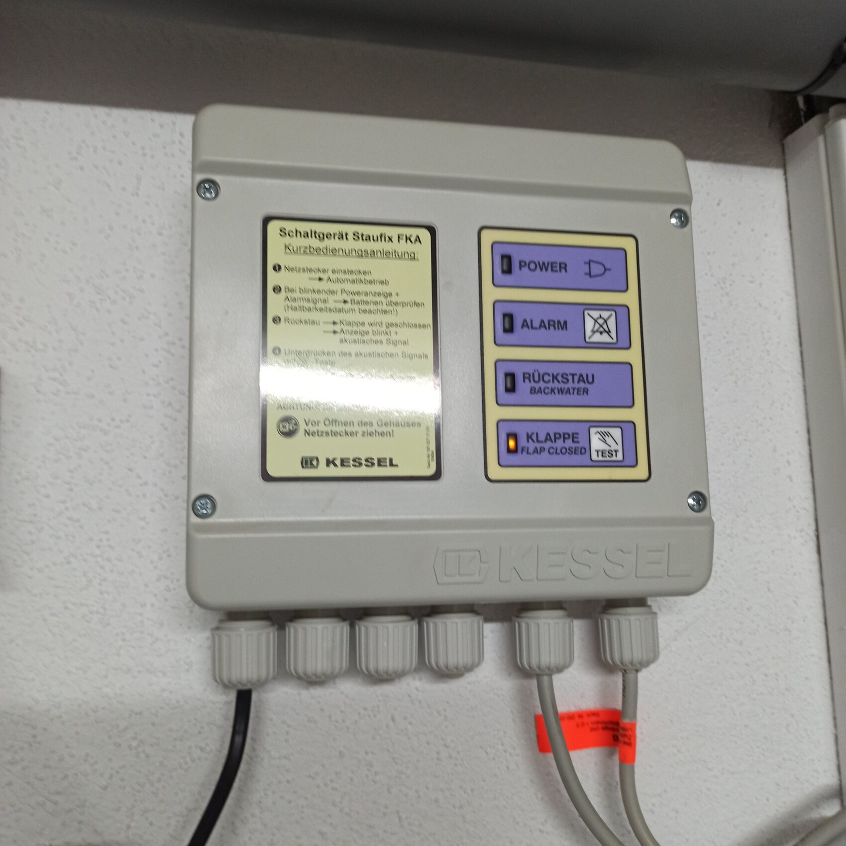

Sonne_ist_toll8 Feb 2024 06:58There is an update. I have completely removed the water. Next, I scooped it out with a shot glass and then soaked it up and dried it with old towels. I forgot to take a photo but will do so later. I found the control unit. It was unplugged. So I powered it on to see what happens. The device starts opening the flap and then closes it again. It does this 3-4 times. You can hear the motor and the flap closing. Afterwards, the device sounds an alarm, as if there is a backflow. I will attach a photo of the control unit here. While the flap was moving up and down, I also opened the manual lever. No water can be heard inside that might have accumulated there. I suspect that either the pipe inside is completely filled with water (clogged), so I don’t hear any water running and the sensor signals that the water is not flowing outwards, locking the flap. But it could also be that the flap is locked because the sensor is defective. However, then I would expect to hear some water splashing when I turn on the water. My question to you is: what else could it possibly be that I haven’t considered? Does anyone have a similar flap and knows how the device behaves after initialization? Many thanks in advance!
k-man20218 Feb 2024 13:08For such an important issue, I would call in a professional service, especially if it has already been disconnected. Trust me, water in the basement is no joke, especially if it’s coming from the sewer system.
Buschreiter10 Feb 2024 09:38It seems a problem was simply "fixed" by turning it off. Call for service, this component is important!
