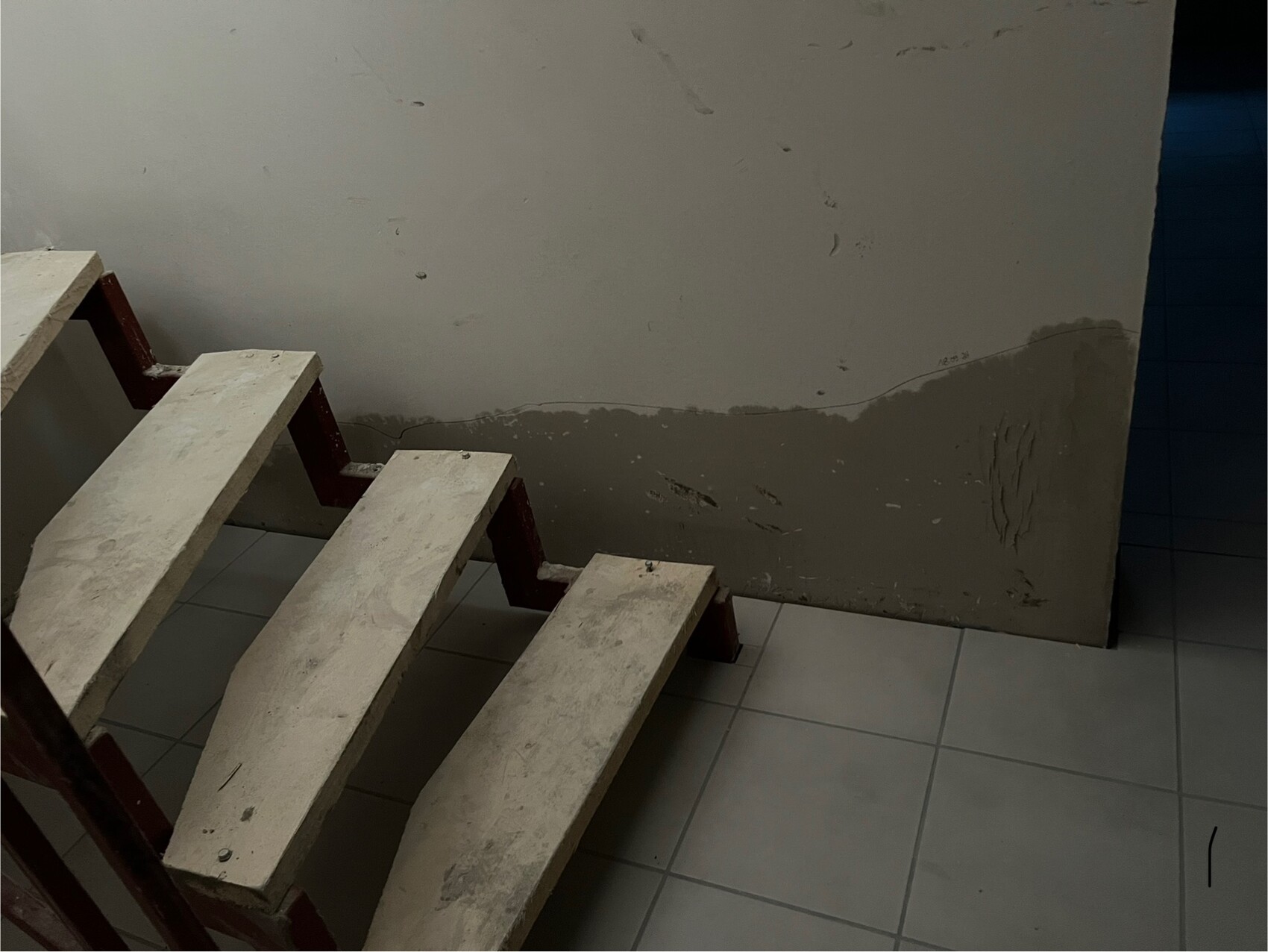

NilsHolgersson21 Sep 2024 14:55Hello everyone,
We are building a semi-detached house with a solid waterproof concrete basement (WU-basement). The shell was completely finished by March. We are currently in the interior finishing phase: the screed was poured in mid-July, before that the underfloor heating was installed, and the interior plaster is already done.
In August, we used two dehumidifiers for two weeks each.
One week ago, my neighbor discovered water damage in his basement (see photo). Visually, it affects the stairwell area (so no exterior walls). On my side, nothing is visually noticeable. The water is rising from the floor; in the photo, the plaster has already softened. Last week, my neighbor’s basement floor was fully tiled. According to the tiler, the CM-value (moisture content) was okay for tiling.
We have hired a water damage expert. Initial findings are: detailed exceeded moisture values (aw over 0.9) on both of our sides. The expert also took samples to determine the water source. However, the costs for this are considerable.
The builder is currently denying responsibility. A meeting on-site with a TÜV inspector, arranged by the builder, is scheduled for Monday.
Questions so far:
1. Can the costs (expert report, samples, etc.) be covered by insurance? If so, which one (homeowner’s insurance, construction all-risk insurance – we have both)?
2. It is strange that the water appeared late and almost in the middle – could it be a floor slab crack? If yes, what consequences would this have? Complete removal of the screed? Could this be caused by tiling?
3. How does the root cause investigation typically proceed?
Any tips or advice would be appreciated.
Thank you very much!
Nils

What a mess!
I assume there is a soil investigation report available to rule out groundwater?
Possibly construction all-risk insurance, do you have that?
However, I would first hold the construction company responsible.
No, water slowly finds its way through the masonry when the cause is a leak.
Tear open the surfaces?
You might be able to tell from the plans if there are pipes running nearby. It could also be a leak in the underfloor heating.
As a comparison/note: We had a similar damage pattern on the walls from below in our ground floor office. The cause was a leaking outdoor faucet, the water accumulated between the slab and the screed and then traveled up the walls. Luckily, we hadn’t installed any floor covering yet in the affected room (guest room). We repaired the outdoor faucet, placed a drying unit inside, and eventually, everything dried out.
NilsHolgersson schrieb:
Is it possible to cover the costs (report, samples, etc.) through insurance? Which one though (builder’s insurance, construction all-risk insurance – we have both).
It’s strange that the water appeared so late.
How does the root cause investigation work?
