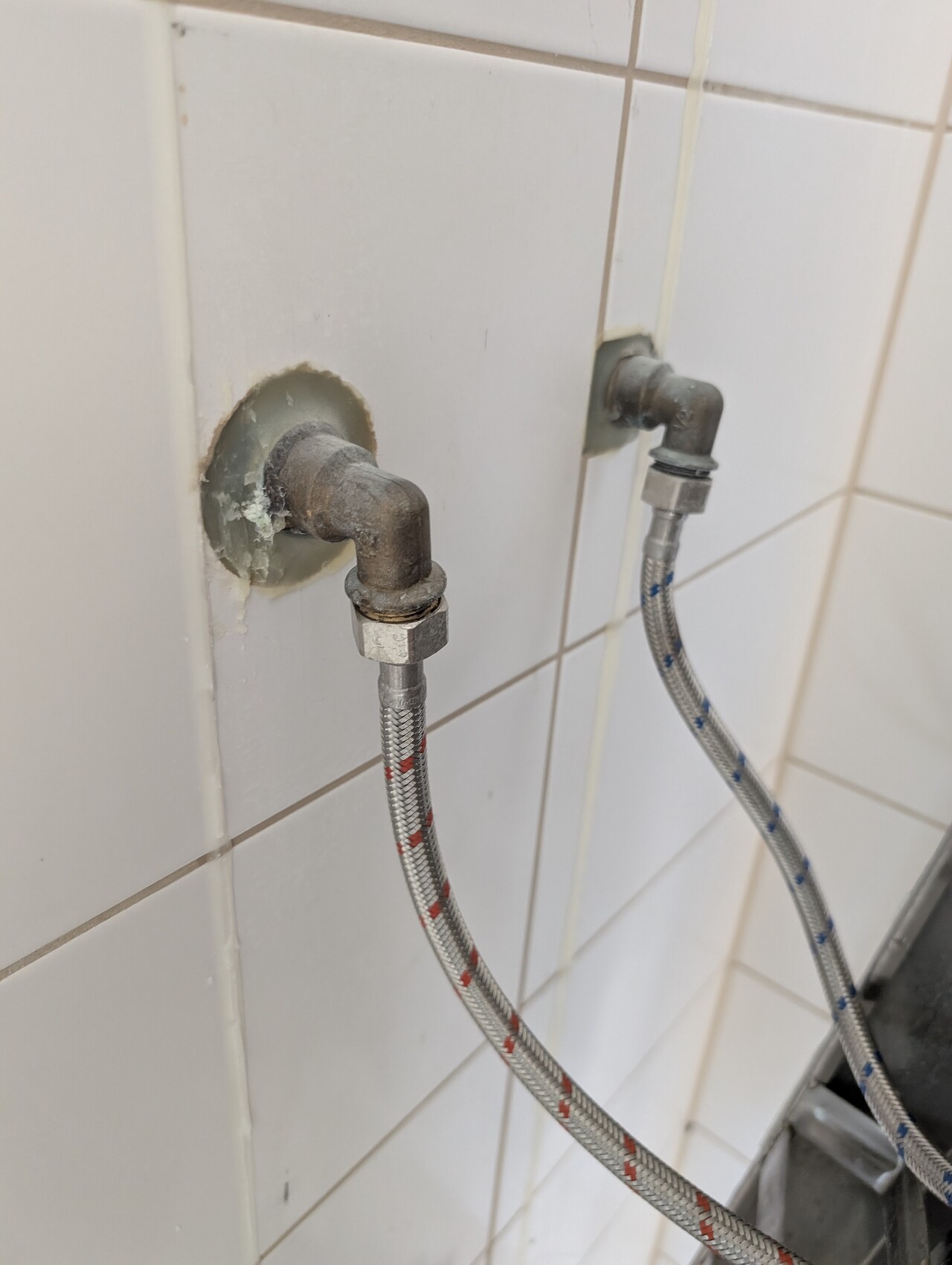

I am currently in the process of replacing an old shower panel with a standard shower mixer and came across the following water connection, see attached picture.
I am not used to seeing pipes coming out of the wall at an angle, so my question is: can I proceed without causing any damage, or was it intentionally installed this way back then, meaning nothing can be screwed on?
In case you're wondering, no, I haven’t tried to unscrew anything yet because I don’t want to risk damaging anything.
Thank you very much

Arauki11
11 Aug 2025 16:07
They probably don’t come out of the wall as an angle; the 90-degree angle was likely screwed on, and that’s what you see now. Therefore, this angle should also be removable by unscrewing.
yorolf87
11 Aug 2025 17:57
Great, I was thinking the same. Still a bit surprised since only the angles are visible and the rest is hidden behind the silicone. I’ll start unscrewing it now.
Arauki11
11 Aug 2025 18:01
You could also start by exposing the silicone or the other end in the Wanf a bit. Then you should be able to see it.
