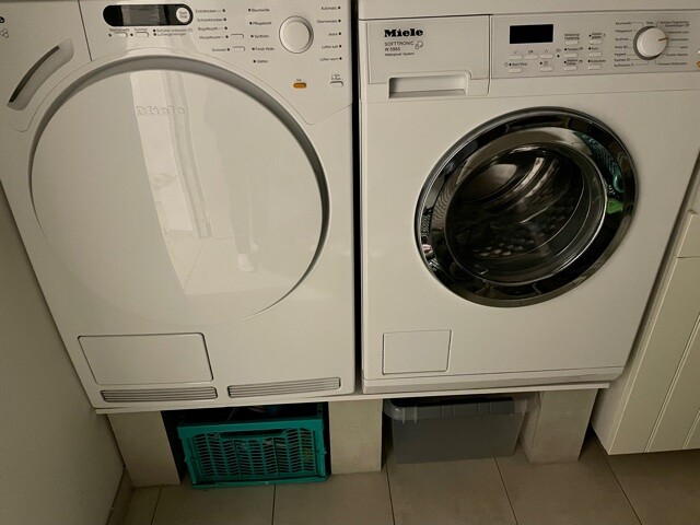

Traumfaenger24 Aug 2021 22:14XAMMAX2 schrieb:
I was actually planning to pour the slab myself on top, but somehow I don’t like that idea.
… Or does anyone have a cost-effective suggestion? Everything in the picture above just looks ugly. We used a wooden board, and it has withstood all spinning cycles and so on for two years now. Just painted white, done.
chamäleon26 Aug 2021 06:08How does the sound behave with such a hollow space beneath the appliances? Doesn’t it cause a lot of noise or vibrations?
Traumfaenger26 Aug 2021 22:04chamäleon schrieb:
How does sound behave with such a hollow space beneath the appliances? Doesn’t it cause a lot of noise or echoing? No, even though the kitchen shares a wall with the utility room, you can barely hear the machine spinning. That means we always check if the machine has finished or simply set an alarm on the oven clock ;-) I should add, the machine itself is not noisy. Also, our house is generally quiet, with music rarely playing during the day and no TV.
