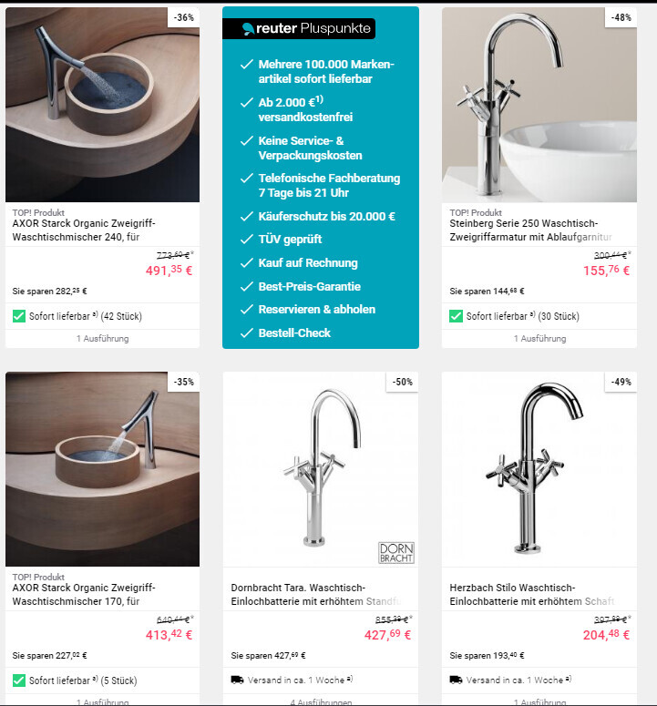

I can only agree with Pagoni; I found CoolStart at Hansgrohe, which addresses your energy concern.
If you really want a tall two-handle model, I recommend using the filter options at one of the two large bathroom online shops (which I cannot link here) and setting:
Faucet type: Two-handle mixer
Features: Raised faucet body
This way, you will find suitable products for your preference. I found six options from Steinberg, Dornbracht, AXOR, Herzbach, and Grohe.
I’ve attached a picture for you.
