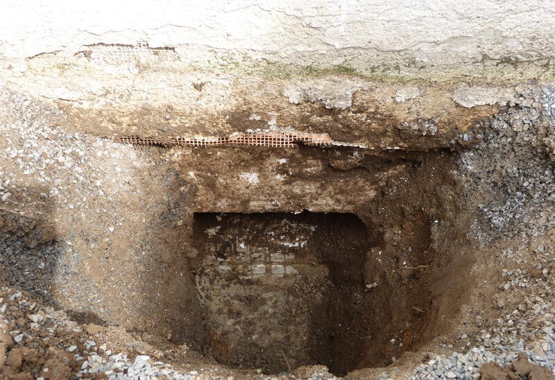

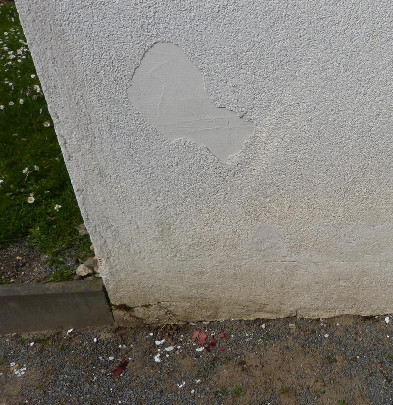

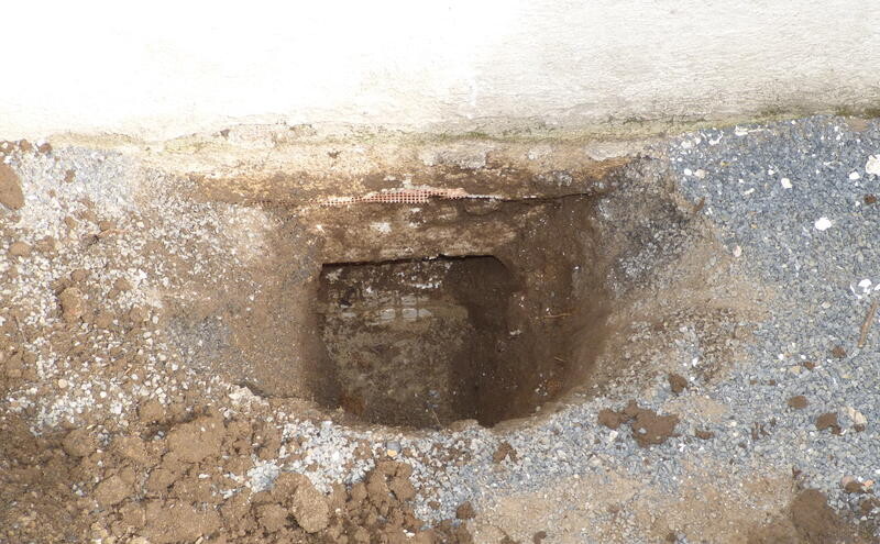

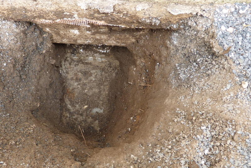

In 2011, we purchased a condominium in a two-family house (built in 2003).
In 2013, the other unit was also sold. Now, the other owner and we want to redesign the front yard and pave some pathways as well as the parking spaces.
Since we have been experiencing problems with the plaster on two sides of the house (blistering, crumbling) for some time, and a landscaping contractor brought to our attention that the insulation might not have been properly installed, we want to have it assessed to understand what might be faulty, what needs to be fixed, and how this should be done.
As a note: we have no moisture or mold issues in the basement rooms!

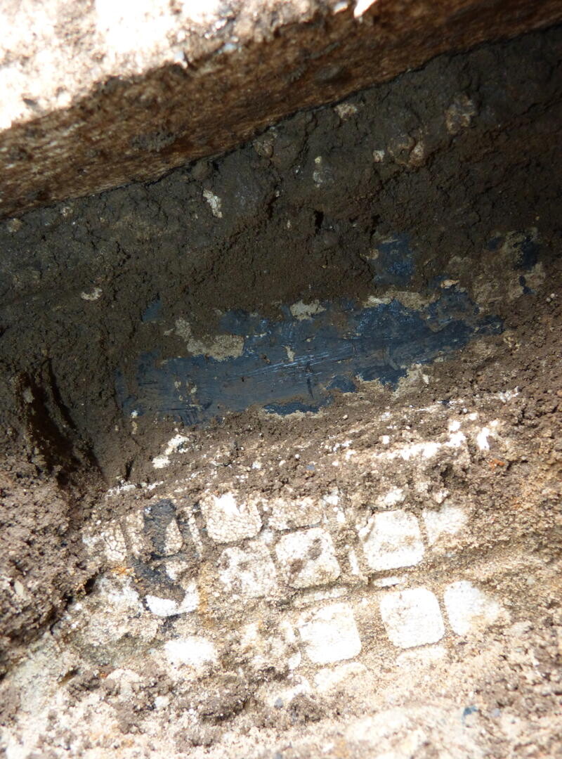

It appears that the insulation was glued directly onto the black coating on the basement wall. Then, the soil was piled directly against the insulation. I do not see any membrane, dimpled membrane, or similar protection.
Above the basement insulation, there is about 10cm (4 inches) without insulation, then the main wall insulation with plaster, which extends down into the soil.
I believe that after more than 10 years, moisture (from rain, etc.) has caused the plaster to discolor, crumble, and bulge outward. (see photos!)
We plan to pave right up to the house soon but want to resolve the current issue first. What should be done?
