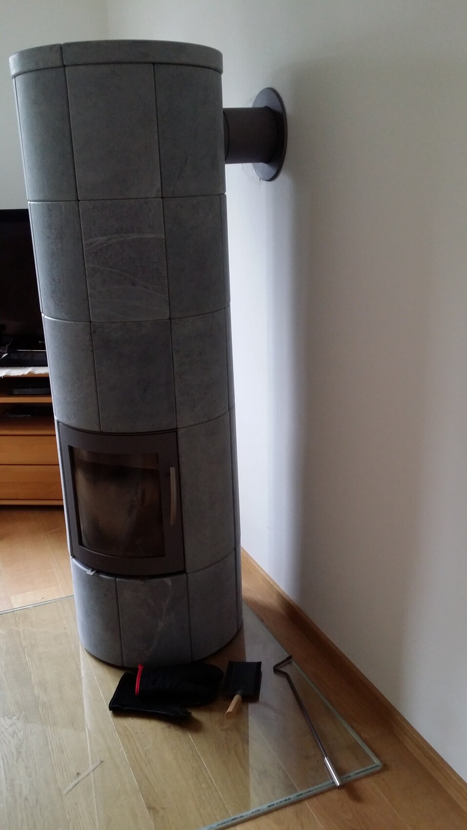

Doc.Schnaggls25 Aug 2014 15:07Hello Björn,
The clearance to combustible materials is clear – our main concern is whether a photo wallpaper might discolor due to radiant heat...
We have a Lotos M3 soapstone stove with fiber fleece behind it. Nothing discolors there. It only gets really hot at the front near the door.
I would have liked to include a photo, but apparently that is not possible via Tapatalk.
Sylvia
Sylvia
