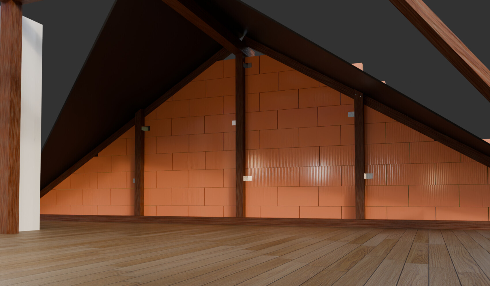

I am planning to build a non-load-bearing partition wall in my attic using 8DF Poroton bricks (11.5 cm (4.5 inches) thick).
For lateral stabilization against tipping, I am considering attaching the wall to the surrounding wooden structure (roof frame) with a sliding connection.
Planned execution:
Background:
The wall currently stands in front of the neighboring exterior wall (stone wool insulation behind it).
In a few years, the neighboring wall will be demolished (for an extension), so I want to build my 8DF wall in such a way that it remains stable and resistant to tipping even without that rear wall, and without generating internal stresses due to wood movement.
Question:
From your perspective, is this sliding connection for stabilization reasonable and technically correct?
Thank you very much for your input!
