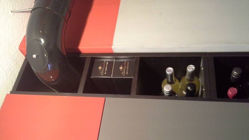

robi_aus_ffm7 Mar 2017 10:29quote:
What happens when you reduce the size of a cabinet like that? Does it still look neat afterward?
That depends on your craftsmanship skills and the tools you have.
I shortened these 20cm (8 inches) in height, which doesn’t show any visible signs. When cutting the width, you might need to drill new holes for the shelves or baseboard on one side, or if it’s the side facing the neighboring wall cabinet, you may have to screw it from the outside.
