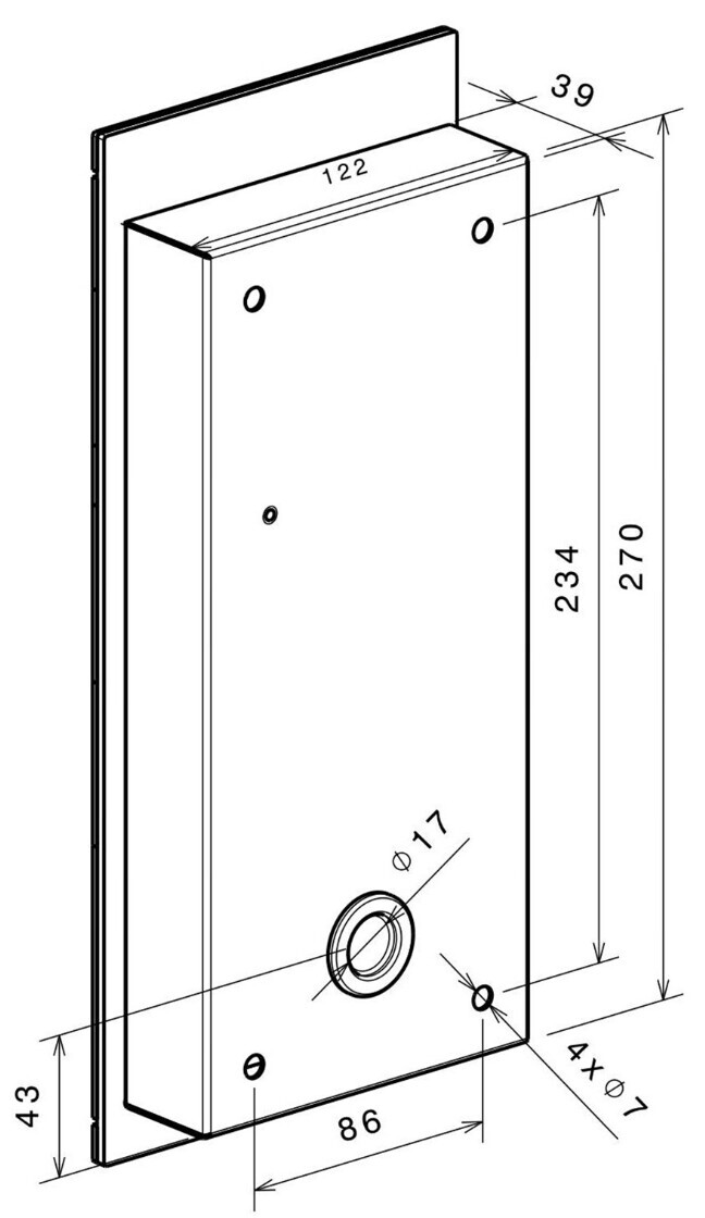

Unfortunately, I can’t find one that fits the sizes. 100x220cm (40x87 inches) is too small...
This is the installation diagram I need

sysrun80
24 Jun 2023 21:25
Length: 220 mm (8.7 inches)
Width: 100 mm (3.9 inches)
Height: 60-160 mm (2.4-6.3 inches)
The width is fine. However, I need a length of 234 mm (9.2 inches) 😕

sysrun80 schrieb:
The width is fine. However, I need a length of 234mm (9.2 inches) 😕
It’s the same with my outdoor installation; you can either install two brackets or drill new holes in the flush-mounted box accordingly.
The bracket doesn’t have to be flush with the unit, it just needs to serve as a kind of “anchor.”
sysrun80
24 Jun 2023 21:39
I think I'll go with the beam and simply drill new holes.
Thanks again for the tip!
