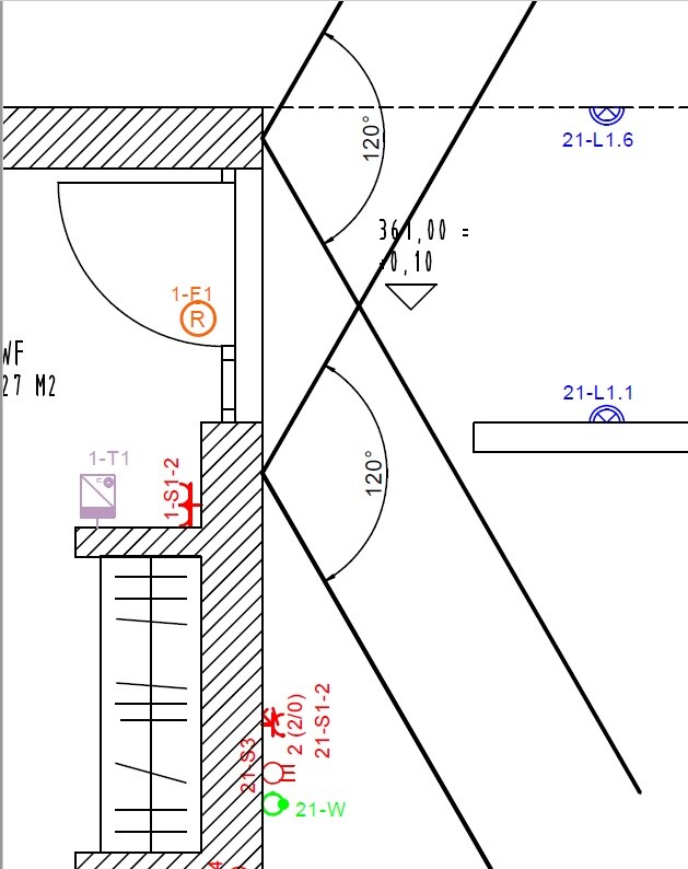

Thanks for the explanation, one more question:
2N states a horizontal viewing angle of 120° for the camera.
Can the camera itself still be rotated inside the housing?
Our issue is as shown in the picture. The detection area only starts about 60cm (24 inches) away from the door.
I know that most people tend to step back after ringing, which would actually place them within the camera’s field of view.
But if someone stays right in front of the door, I can no longer see that person.
Thanks for your help!
