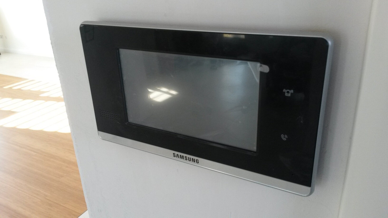

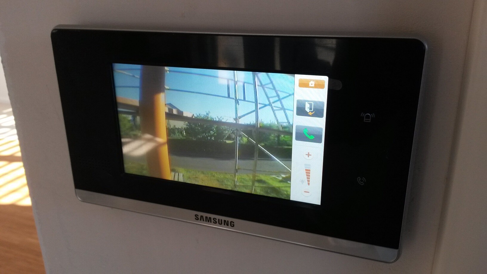

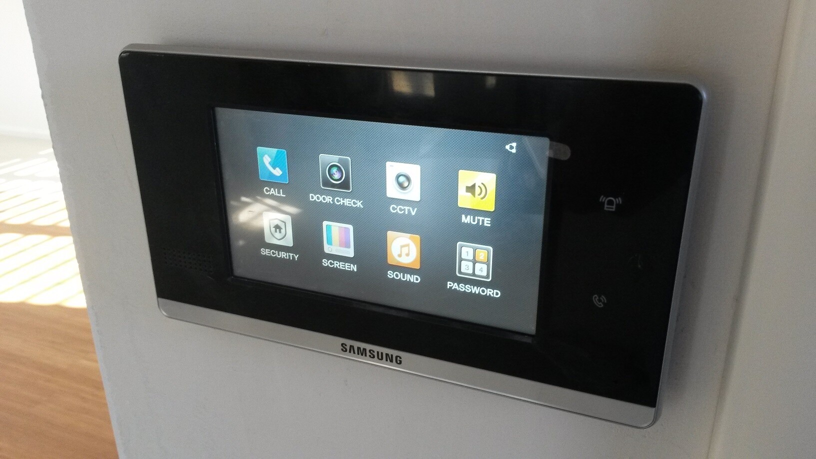

I can recommend the Samsung SHT-7017XM.
7" TFT LCD color screen with touchscreen.
Expandable with up to 4 indoor stations, 1 outdoor station, and 1 surveillance camera.
Mute mode.
Alarm function if the outdoor station is dismantled.
However, it does not take snapshots when the doorbell rings.
3x SHT-7017XM
1x SHT-CP611
1x flush-mounted box for outdoor station
1x DIN rail power supply
=1,200

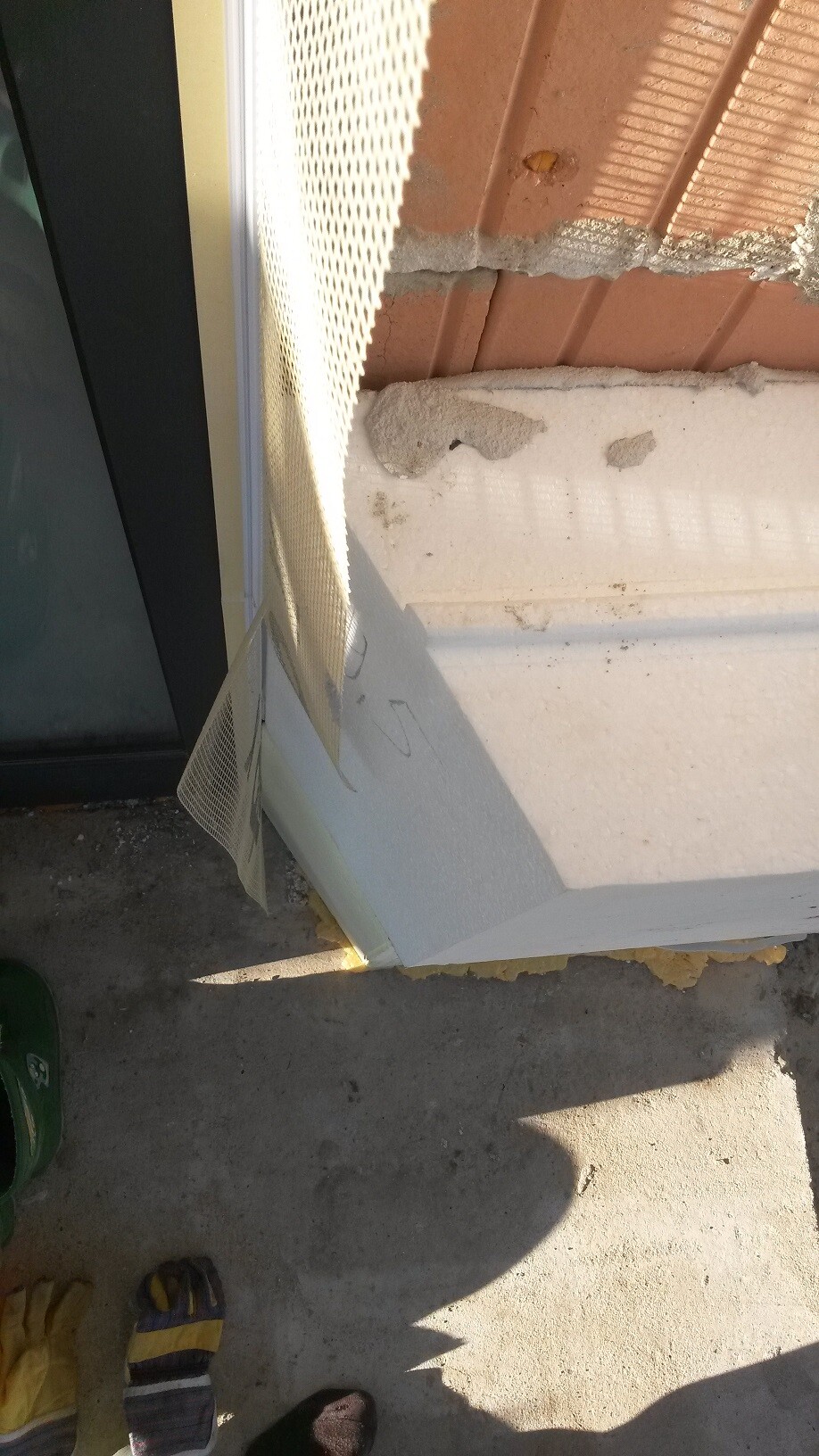

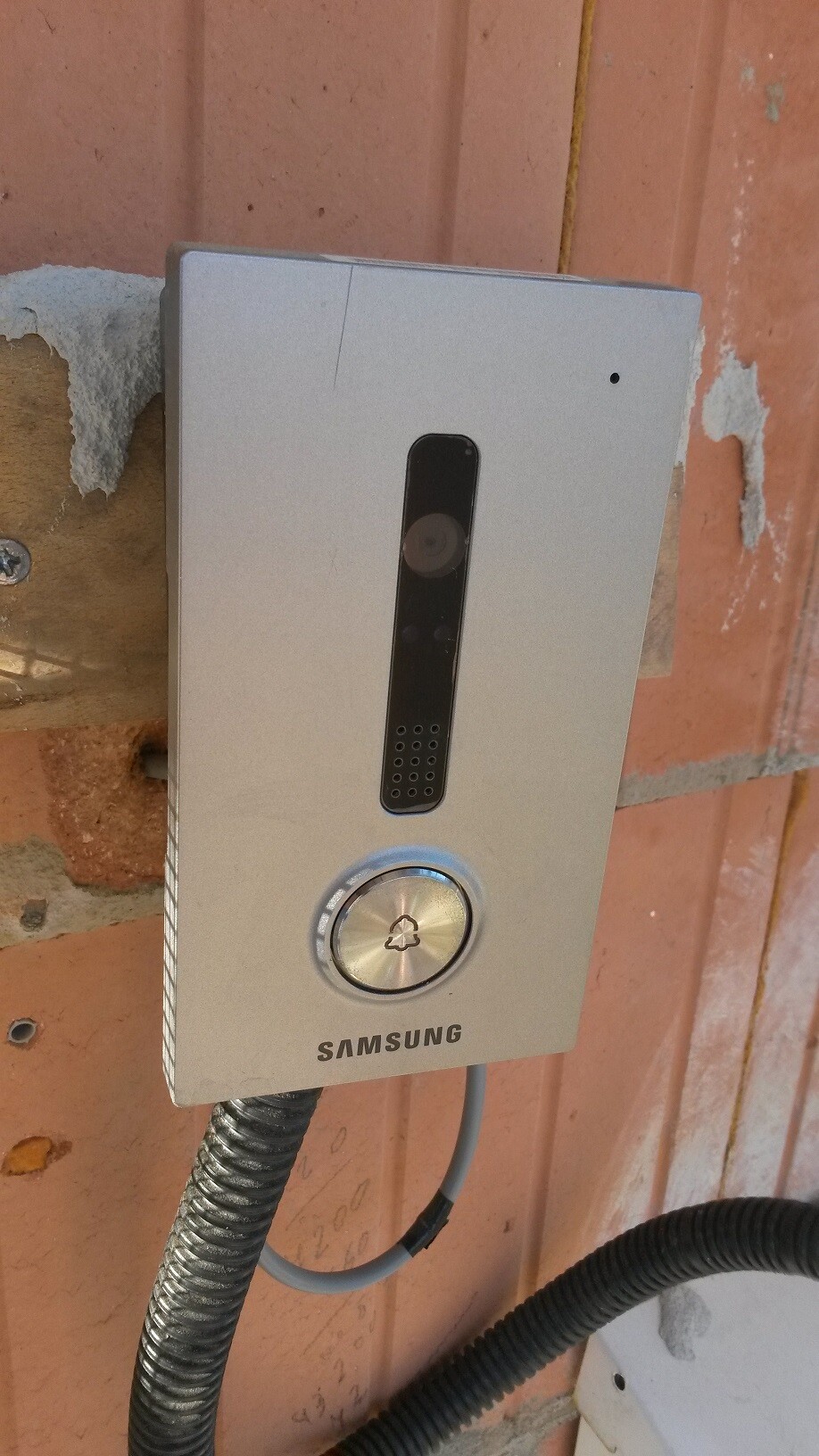

Instead of the surface-mounted SHT-CN610E, I chose the flush-mounted SHT-CP611 outdoor station.
This is a flush-mounted outdoor station, and the camera is hardly visible from the outside, which I personally like.
However, this is also a disadvantage when it comes to the detection range.
For example, Gira has a large lens in front of the camera, which I didn’t find appealing—big camera outside and a tiny monitor inside.
The SHT-CP611 outdoor station has only a 75° detection range. I simply cut my external thermal insulation composite system (ETICS) panels in the entrance area diagonally on the right and left sides so that the cut surface is perpendicular to the area in front of the door, and the outdoor station is mounted on the front edge of the insulation.
This ensures good alignment of the camera, and with the angled cuts, the entrance area looks nicer.
The disadvantages of the system:
The manual is only available in (I believe) Korean and English. However, it contains many images and is easy to understand.
The SHT-CP611 outdoor station emits a quiet humming sound. This is only noticeable in the evening when it is quiet outside, but it does not disturb communication. I don’t know how other outdoor stations behave in this regard.
