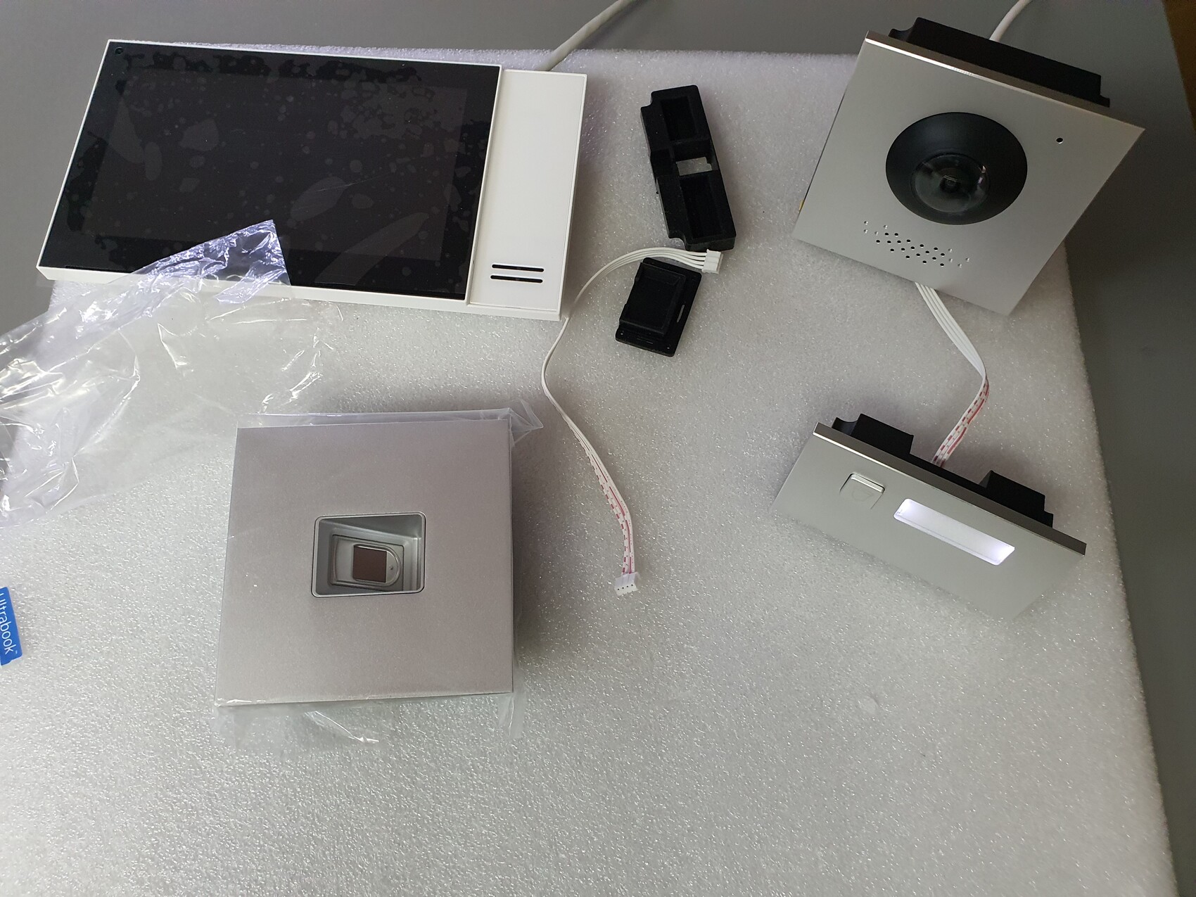

knalltüte28 Oct 2020 14:27Traumfaenger schrieb:
For the sake of completeness, I have tried Dahua. The installation is definitely not plug & play (nor are the German brands that cost twice as much), but it works reliably afterward and, unlike the alternatives mentioned above, can be configured so that not all data is routed through foreign servers. I am very satisfied with the system now (doorbell, additional cameras, switch, etc.).Have you tried these (turm.tech / Dahua)? (Still on my testing bench.)
Personally, I find them far from plug & play, but now I have to “push through.”
The build quality and video performance are excellent, even in the dark. The HEK is around 500€ (net) for all components...
Traumfaenger24 Mar 2023 20:11Have you had any experience with whether it’s possible to stream the camera feed continuously to the monitor with Dahua or other systems? With Dahua, it’s very complicated and only works on a PC via the browser (Chrome extension), and after a while, it always requires the user to log in again, which is extremely annoying. Also, according to the Task Manager, the extension causes very high power consumption, and you can tell from the loud fan noise when this app is running. On the Dahua monitor itself, which belongs to the door station, an image is only shown when someone rings the doorbell. You can connect additional cameras, but their feed also cannot be streamed continuously.
I asked Metzler customer service, and their door stations and indoor monitors also do not support continuous streaming, even for extra cameras that are not built into the door station.
It shouldn’t be rocket science to permanently display the camera feeds on the screen upon customer request, right? The reason is that we specifically installed two cameras at the entrance area because it is somewhat hidden around the corner, and we would like to be able to see if someone is standing just out of view (that’s exactly why we have the second camera, whose feed is very cumbersome to access).
