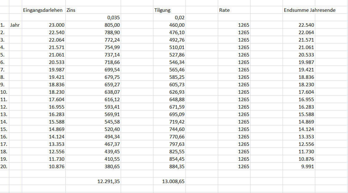

Christian 65
8 Oct 2022 13:05
RotorMotor schrieb:
Here is the answer made even simpler. Yes, you miscalculated.
Interest would be €9,013 (about $9,880), but this can be completely ignored since the increase is also not considered on the electricity costs.
If that is also around 3-4% per year, it balances out.
However, your €9,013 ($9,880) is incorrect with 2% repayment and 3.5% mortgage interest. With a fixed payment, it comes to about €12,300 (about $13,470).
And after 20 years, nearly €10,000 (about $10,940) remains on the loan balance.
20-year loan schedule with interest, repayment, payment of 1265 and year-end balance
