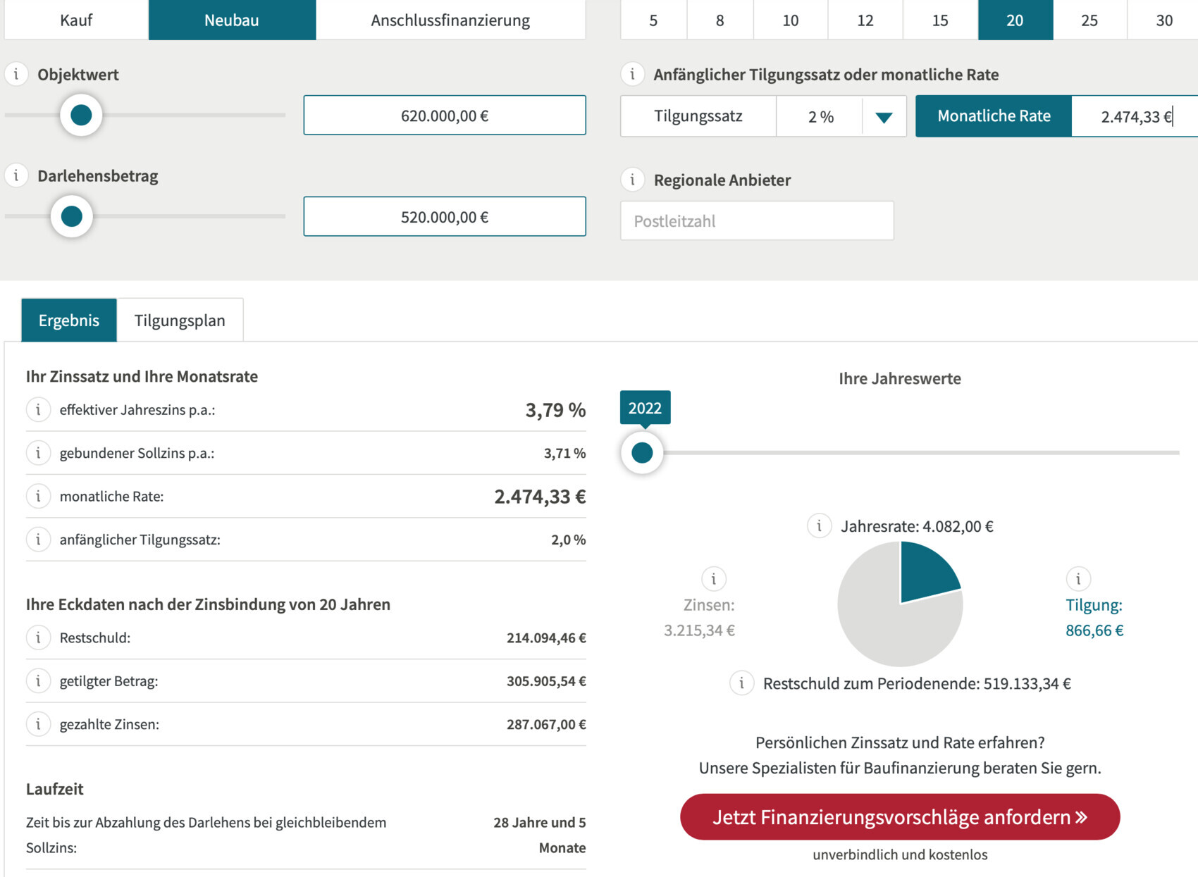

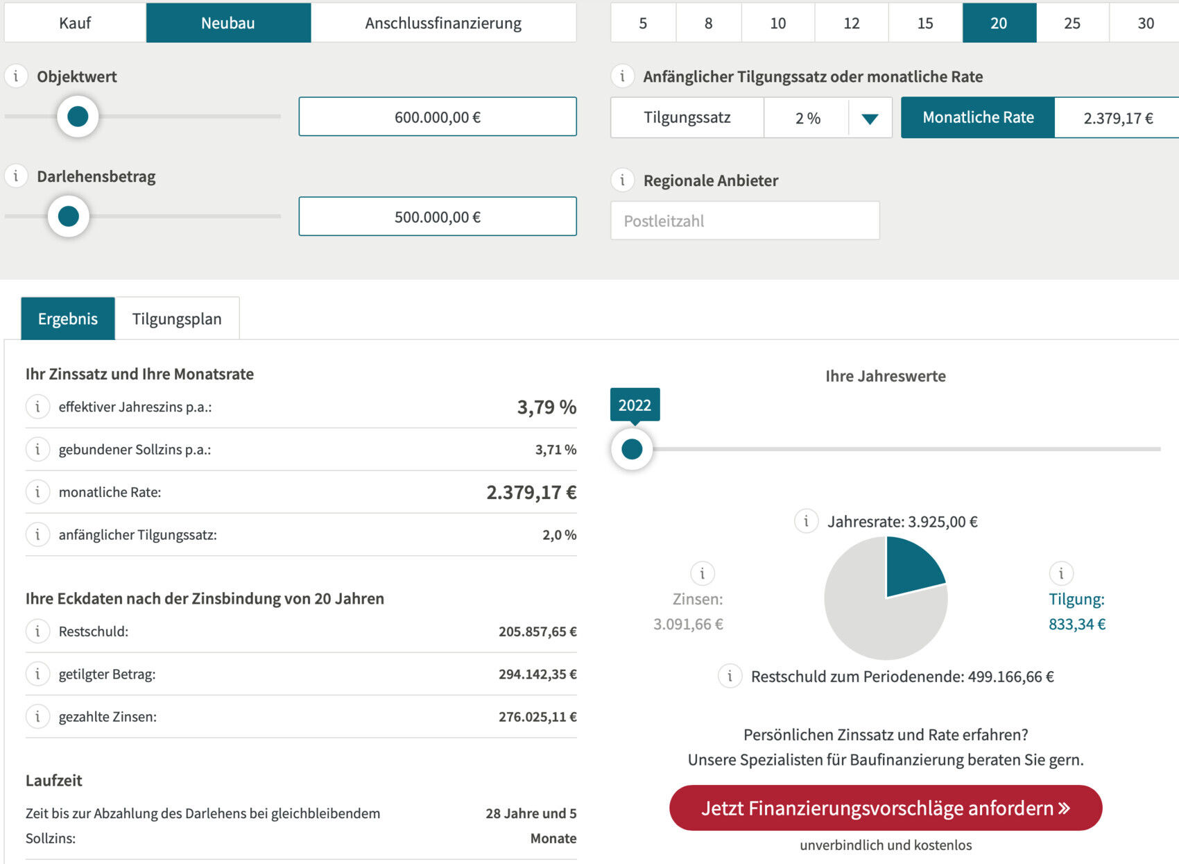

If you want to argue about interest rates, here are two screenshots from a construction financing provider comparing a loan that is $20,000 higher.
Affordable heating system:

Heat pump:

As you can see, the monthly payments are roughly the same when including operating costs. I stick to my view that I would not recommend this system to anyone who isn’t at least building a passive house. Regular single-family house construction should be much more comfortable and reliable in the long term with a heat pump and underfloor heating.
