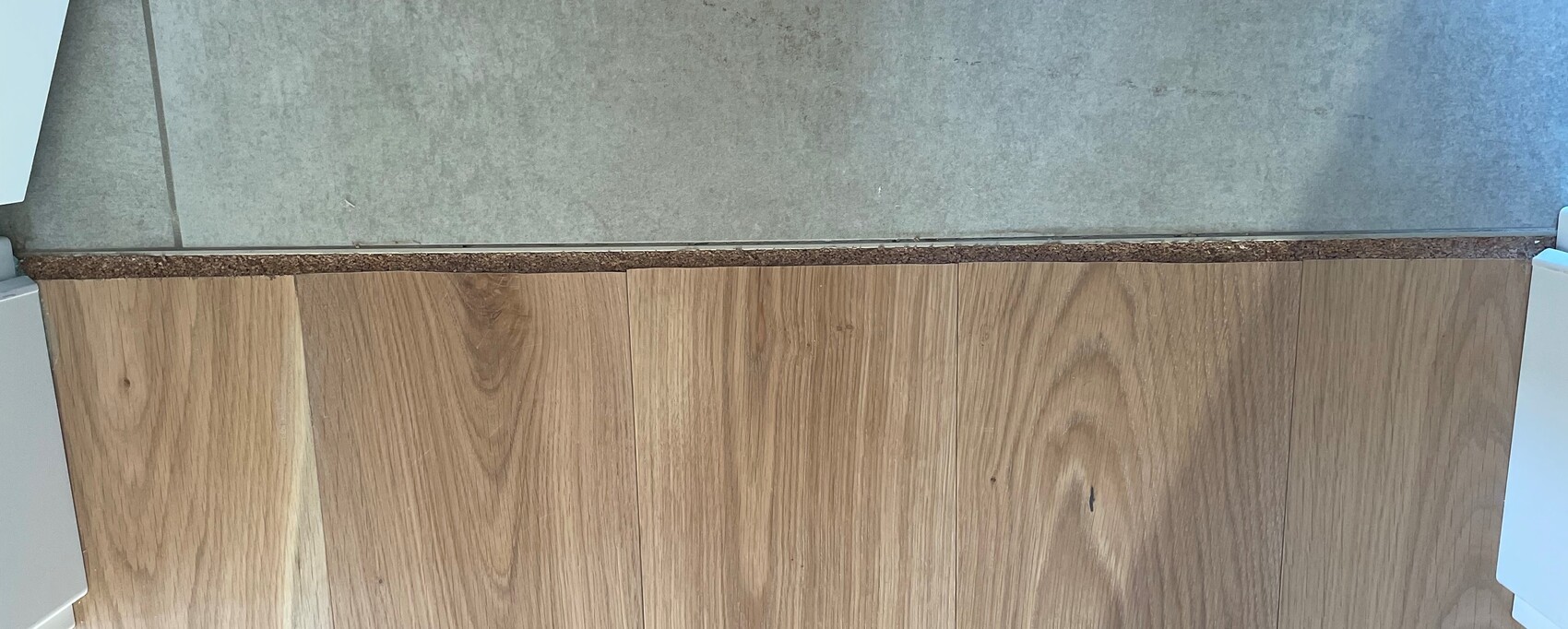

As you can see in the photos, the gaps at the transitions are about 1cm (0.4 inches) wide and filled with a cork material that does not match the color.
The baseboards (1.8cm (0.7 inches) wide, about 5.8cm (2.3 inches) high) at the floor-to-ceiling windows do not look good, the smaller baseboards/profiles are odd, and the work was very untidy. The reason for the unusual small baseboards/profiles: the window reveals are too narrow (1cm (0.4 inches) wide baseboards would fit; this is the case with our neighbors in an identical semi-detached house). There are nicer solutions for this, but there was no communication that the baseboards would not fit. The parquet installer is unable to accept criticism and is old-fashioned, just doing things as he learned 30 years ago. He refuses to make any corrections.
Regarding the cork filling, we probably have no legal chance for corrections, even though the boards at the transitions were cut unevenly. (I saw examples from other providers, unfortunately too late, and spoke with specialists from a large parquet company (Parkett Dietrich) who said that transitions without joints or with very small joints about 4mm (0.16 inches) are possible. These could be filled with parquet joint filler in a similar color and would look a thousand times better). Baseboards before the step in the staircase area???

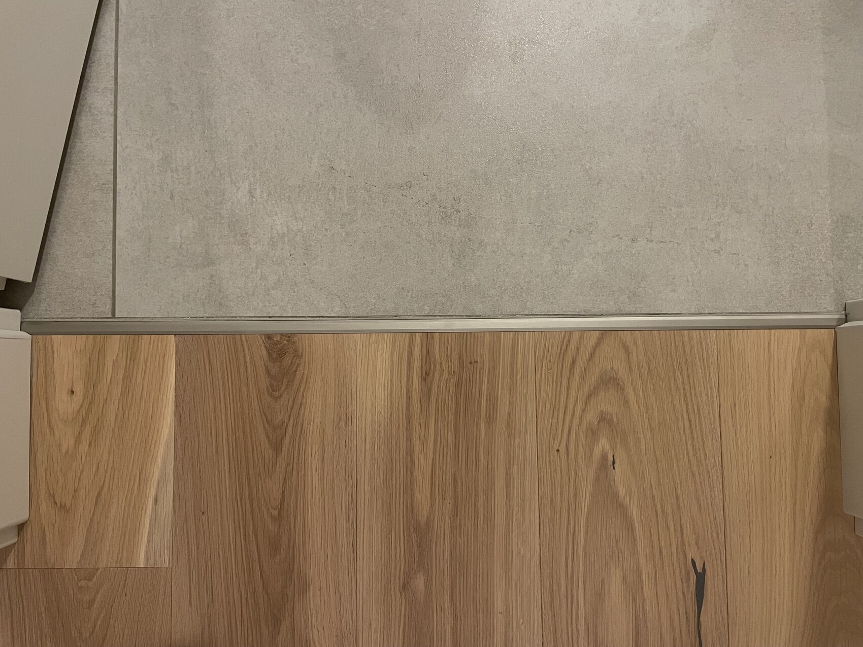

Cork expansion joints can be seen in all door areas. Although I find these cork joints extremely unattractive, the flooring installer said they are necessary. However, they should not be cut unevenly. For example, a cork joint at the left corner measures 1.7 cm (0.7 inches), while at the right corner it is 0.8 cm (0.3 inches). There is no standard (DIN or otherwise) allowing cork joints to be uneven like this. The flooring installer’s proposal was to straighten all crooked joints, which would mean making them all oversize everywhere. There are a total of seven cork expansion joints, all cut unevenly and crooked. Visitors have already asked, “Is it going to stay like this?” For a contract worth nearly 25,000 EUR, this is unacceptable. Especially the cork joints between the tiles and the wood flooring were impossible to accept. Since I could no longer tolerate seeing them, I repaired these myself (see photos of bathroom and guest WC). From the beginning, I did not want transition strips, but now I believe this is a good solution. The other transitions will be repaired later. A skilled flooring installer nowadays can cut out and replace a single plank from the center of a room. In the other door areas, only one plank needs to be replaced, while in the bathrooms it would be six planks each.
Before
Close-up of wooden fronts of a kitchen cabinet with gray stone countertop

Door threshold with metal profile separates gray flooring above from wooden floor below.
AllThumbs
10 Feb 2023 10:26
Looks clearly better and intentional!
It's really crazy how crooked and uneven the adjacent floorboards were cut by the parquet fitter. It seems like they didn’t even use a circular saw, but just freehand with a jigsaw 🤨
