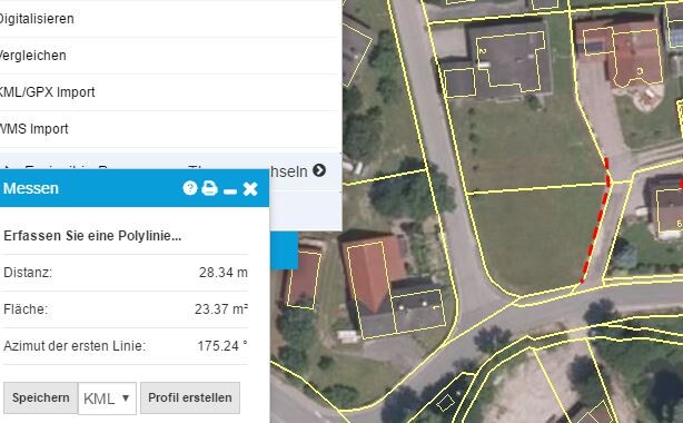

Plot size: flexible between 700 and 950 m² (7,535 and 10,225 sq ft)

Aerial view of a building plot with red outline and measurement window for planning
Aerial view of a land survey with yellow boundary lines and road layout
Section of a building plot with yellow boundary lines and buildings in the planning tool

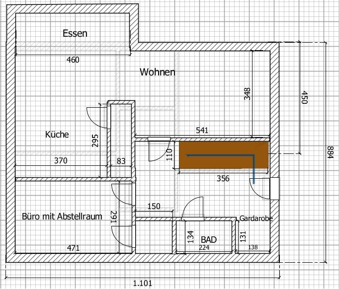

Here are some new drafts from me:
I actually quite like the attic layout. On the ground floor, the bathroom feels too large to me, but I’m not sure how to make it smaller since the staircase limits the space.
The small storage room in the office is intended for the vacuum cleaner, mop, cleaning supplies, and so on. I would prefer not to keep those items with the food.
Upstairs faces southwest.

Grundriss einer Wohnung mit den Räumen Essen, Wohnen, Küche, Büro mit Abstellraum und Bad.

31 May 2017 13:29
Forgot to include a wardrobe. That also solved the issue with the bathroom.
Floor plan: kitchen, dining, living, bathroom, office with storage room, wardrobe; dimensions.

31 May 2017 13:43
The pantry doesn’t work. You lose some space due to the plaster on the 83 cm (32.7 inches). Once you put in a shelf, you won’t be able to fit inside anymore. You basically have just enough storage space that would also fit in a kitchen cabinet.
The storage room is similarly small to the pantry. You might want to consider a large standalone cabinet here as well.
Do you really want to convert the office into a bedroom? In that case, there would be no shower.
Upstairs, I don’t like the doors to the bedroom and walk-in closet. I might consider removing one.
Try drawing in all your existing and desired furniture. Some areas just seem a bit small and cramped to me, but I could be mistaken.

31 May 2017 13:44
I don’t like the pantry. Instead, build it into the 370mm (15 inches) wall and create an opening at the front with a ventilation block in front of it. That way, the potatoes won’t spoil as quickly. As it is now, the pantry is so confined that it’s only suitable for canned beans and ravioli. Karsten

31 May 2017 13:54
Considering a basement, I find a pantry somewhat unnecessary, especially with those dimensions. For the most common items, it’s really better to plan a practical cupboard. Then you can have storage space for a vacuum cleaner, brooms, etc., in a suitable small storage room.
The staircase layout also seems a bit tight to me, especially right next to the entrance.
It is also useful to place a north arrow on the drawing or to sketch the floor plan on the intended plot, or to rotate the floor plan so that north is at the top.
The living area should be facing west, right? Then the entrance would now be on the north side?
