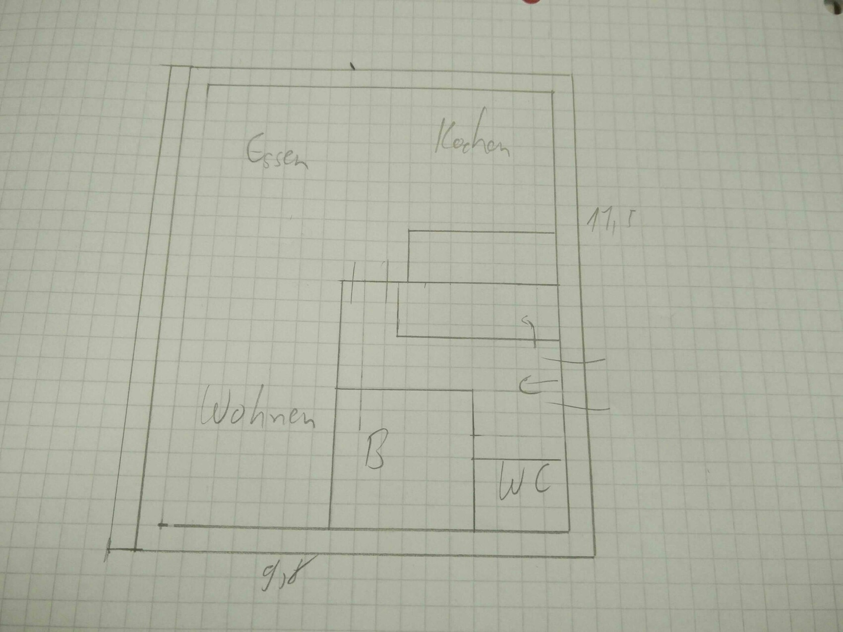

Hello, today I had to wait for an hour and only had my notebook with me... so I just doodled a bit.
This is my very first draft of the ground floor, and it probably still has quite a few mistakes.
What I’m curious about is whether there are any major errors here (for example, the staircase?).
North is at the bottom right.
One square represents half a meter (0.5 m / 20 inches).

j.bautsch22 Jun 2017 12:09Having everything on one side can make the room feel very narrow and elongated. Additionally, this can cause the other rooms to be stretched out significantly. Is the entrance fixed on the right side, or could it also be from the bottom?
EDIT: Structural engineering could make this quite expensive, as steel beams might then be required.
MIA_SAN_MIA__22 Jun 2017 12:10j.bautsch schrieb:
So having everything on one side can make the room feel very narrow. Additionally, the other rooms end up being stretched out quite a bit. Is the entrance on the right side fixed, or could it also be at the bottom? Theoretically, the entrance could also be at the bottom. I only wanted it on the right side because of the garage.

j.bautsch22 Jun 2017 12:30The pantry is now too narrow, and I would always avoid having the staircase entrance in the entry area.
MIA_SAN_MIA__22 Jun 2017 13:24What width should a good foundation beam have?
