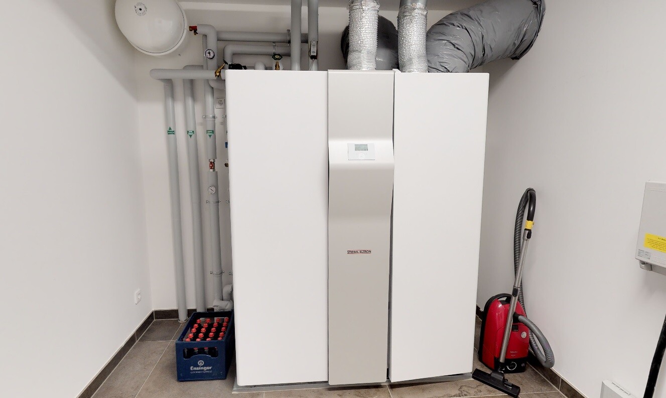

We’re also not working with F.Haus; as I said, it was mainly the ventilation that was very noticeable here. I’ve attached a picture of their equipment from the mentioned show home. I believe this is the heating system with integrated ventilation, not from V.

@AxelH.
We are also not planning with F.H., as I said, the ventilation was particularly noticeable here. I attached a picture of their system from the mentioned show home. I believe this is the heating system with integrated ventilation, and not from V.That's correct, this is not from V. And the crate of beverages shows me that you did not visit the show home exhibition at F.H.'s headquarters but were in the south of the country. Here in Central Hesse, F.H. and V. have a very good reputation. In their structurally weaker region a bit further north, they are among the largest employers. And at least from V., I know that they are not only very active as a sponsor in winter sports but also highly engaged in social causes.Similar topics
