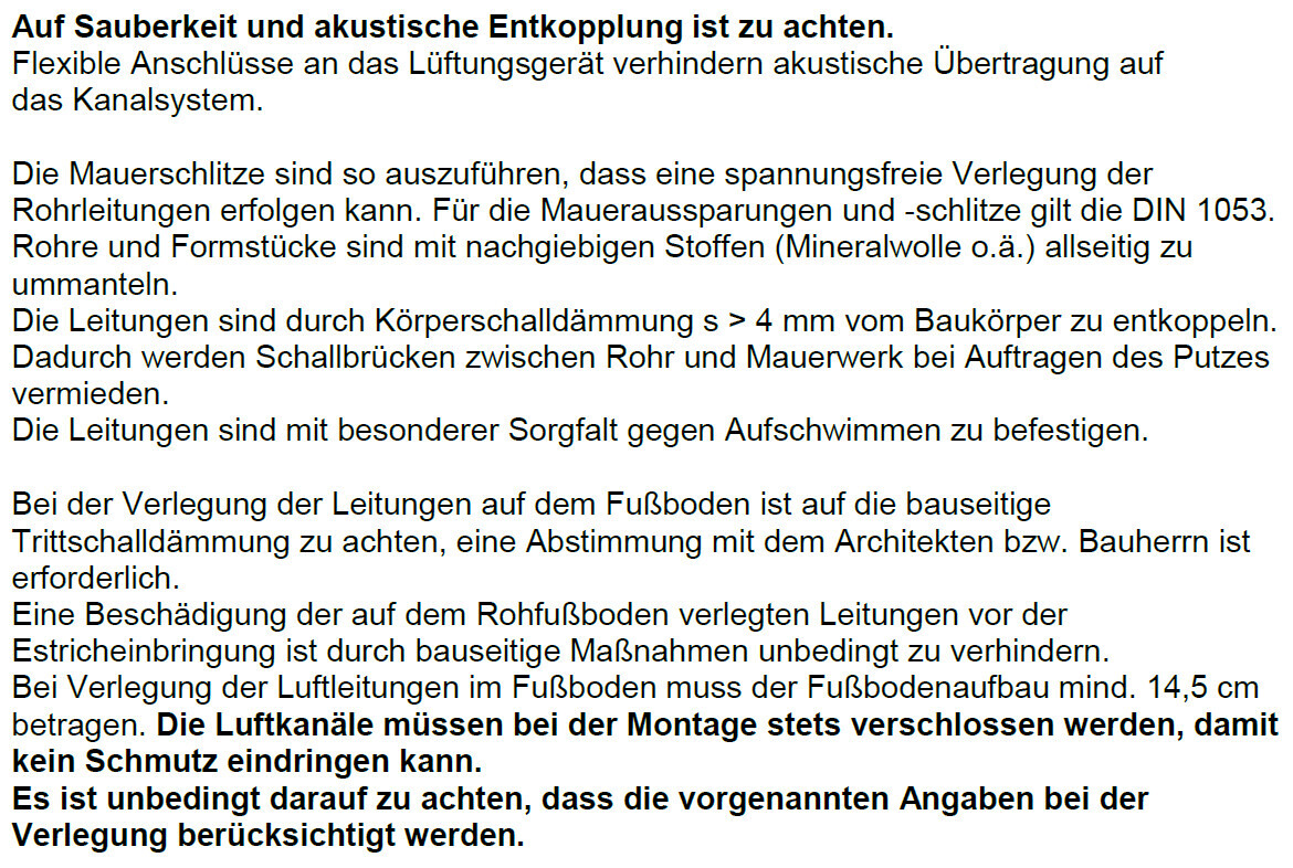

Hello Dany250,
we have been running a Vitovent 300W continuously on setting 3 for over 3 years. Due to the valves in each room, you cannot hear any noise at all. Only the unit itself is audible in the utility room and very quietly in the garden, where the duct for the exhaust air is located.
The system was designed by the manufacturer for us. We have a 9-page document listing all the details. The system was then installed by the contracted company according to this plan.
Another document provides important instructions for installation. Here is an excerpt related to your question:
