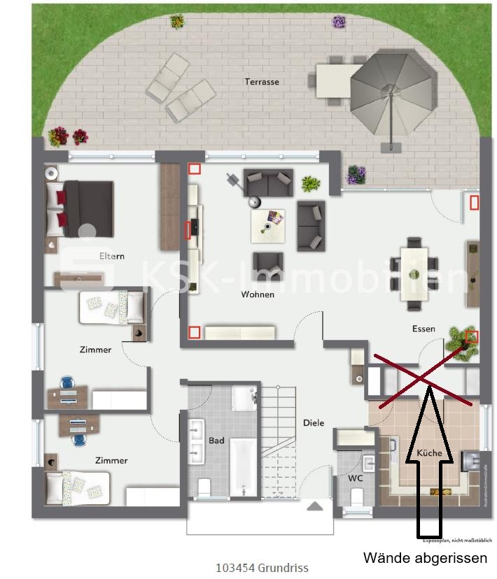

I am currently planning to install several decentralized ventilation units in my single-family home (about 135 m² (1450 sq ft) of living space) and would like to hear your experiences and opinions on this.
I have a floor plan of the house, but I am still unsure about the most effective placement of the fans – especially in the living/dining area (open kitchen), the bedrooms, as well as the bathroom and toilet.
Maybe someone here has completed a similar project and can share advice on optimal positioning.
Additionally, I am interested in:
- Which decentralized fans do you use yourselves?
- Which brands/models have you had good or bad experiences with?
- Which units would you recommend for living rooms, bedrooms, or damp rooms?
- Do you use paired operation, humidity control, or a central control unit?
- How satisfied are you with noise level, air performance, and maintenance?
I appreciate any feedback, preferably with pictures or examples from your homes.
If you can recommend specific models, that would be very helpful.
Thank you in advance!
Best regards, Julia
