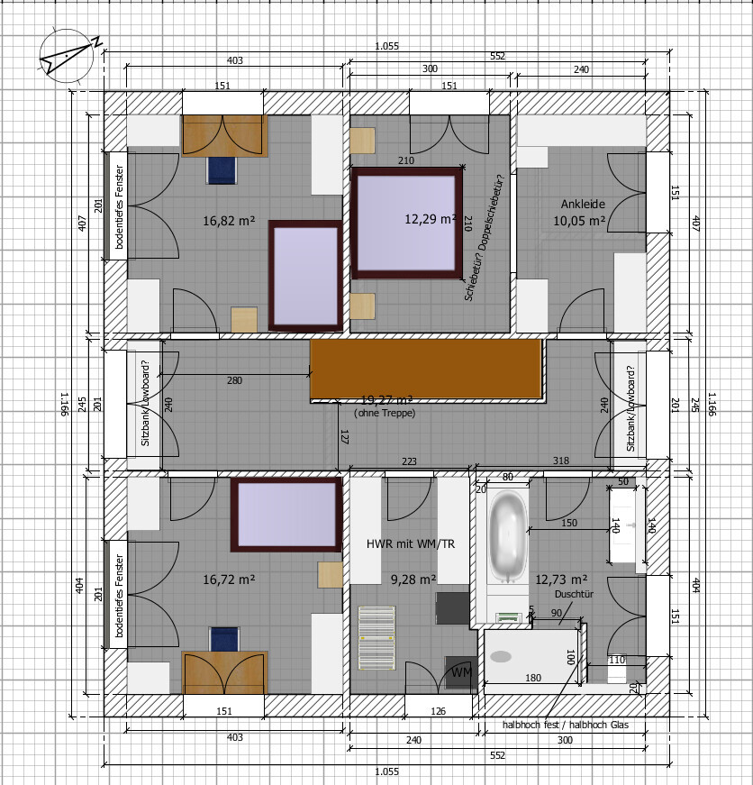

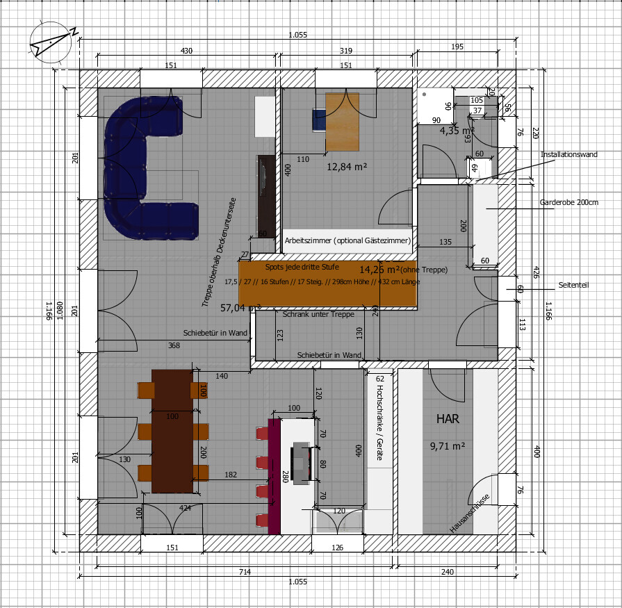

GrymWe will most likely install roller shutters on all sides except the south side. Only on the south side are we considering whether venetian blinds make sense. Here are our floor plans with the precisely aligned north arrow:

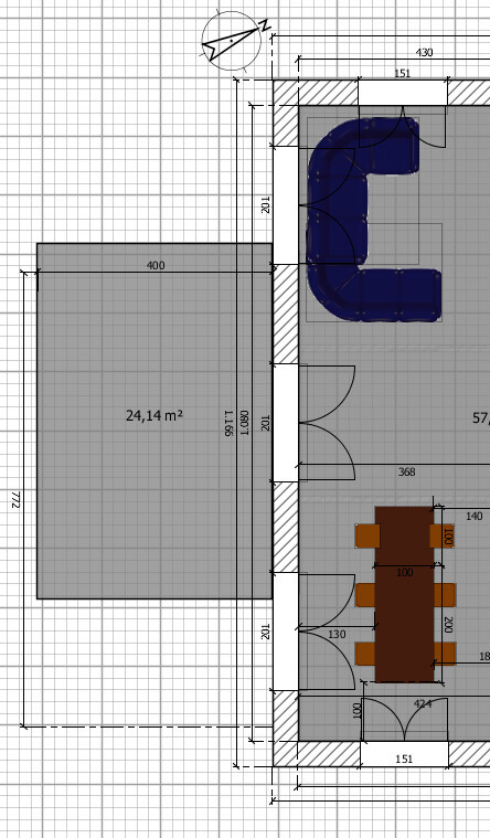

The eaves of the hipped roof (2 full stories) are planned to be 60cm (24 inches) deep. We plan to place a very large sun sail in front of the house, roughly 6x4m (also available in 7x5m or 5.6x5.6m – depending on the manufacturer). Here is a picture:
The deepest corner of the sail would be the upper left corner. The sun sail would be deployed either only as needed or definitely only during the summer.
The reason for the venetian blinds is clear: when the weather is nice outside, you want some shading but not too much, as you don’t want to feel completely shut off from the good weather while inside. In our living/dining area, the two windows in the dining and kitchen areas can be fully opened since they are no longer directly exposed to the sun. In my opinion, the south-facing window in the dining area and the middle window from the sun sail should be protected, so that only the two roller shutters in the living area would be closed.
