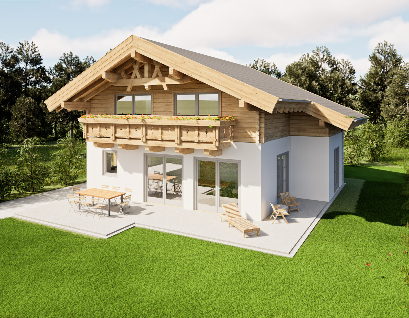

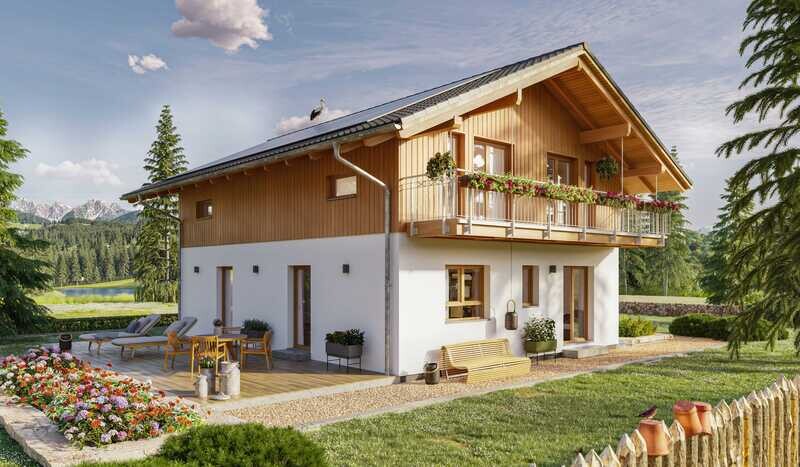

Just to mention in case it’s interesting for someone: These were concepts already proposed to us before our planning by Bien-Zenker and Tiroler Holzhaus. The overall concept will be approximately like shown in the pictures. Of course, these were only proposals, together with our own floor plan, and fully customized for us.
different wall systems of houses, load-bearing capacities, thickness - 691283-1.jpg"]92210[/ATTACH][ATTACH type="full
different wall systems of houses, load-bearing capacities, thickness - 691283-3.png

The houses in the pictures are all custom requests; it’s not just the facade that’s different. The interiors were entirely self-planned with galleries, straight staircases, exposed ceilings, and so on. Tiroler Holzhaus builds for a little more—really not much more—even the upper floor with log walls, although I’m still unsure if that’s a good idea. That will involve too many compromises in terms of energy efficiency, and since we won’t be jumping on the heat pump trend, at least not for now, it’s a moot point.
