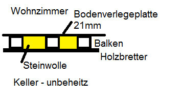

1. The ceiling between the basement and the living room is partly being replaced. The structure is shown in the attached picture; looking from the basement side, there is first a layer of boards, then the existing wooden beams. I want to insulate between the beams with mineral wool and close the top with subfloor panels. Above that will be laminate or hardwood flooring. Now the question is: vapor barrier—yes or no? And if yes, should it be only between the beams or covering the entire surface directly under the subfloor panels?
