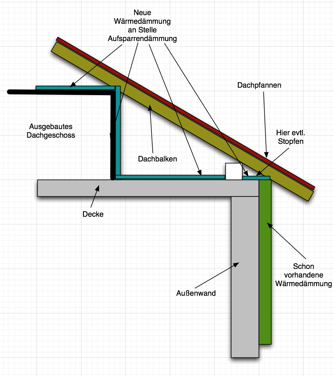

An alternative—which would also be cheaper than above-rafter insulation—would be to insert insulation mats into the space between the roof and attic.
See sketch.

The installed thermal insulation must be able to dry if it is exposed to moisture “from below.” Warm, moist air rises from the living space into the insulation. Somewhere between the cold and warm side of the insulation, condensation occurs. If the insulation is not adequately ventilated, it will remain damp for a long time or permanently, which will inevitably cause building damage. “Adequate ventilation” must be carefully planned and correctly implemented. From my experience, not all architects know exactly how to do this. As a rough guideline: with a 45° pitched roof, there should be a continuous 4cm (1.5 inch) wide gap above the insulation layer, running from the eaves to the ridge, with ventilation at the ridge. This creates sufficient ventilation through the “chimney effect.” This would not be sufficient for a flat roof.
Alternative: A vapor barrier “below” the top floor ceiling. Unlike a vapor retarder, a vapor barrier does not allow any moisture to pass through.

JochenWell. If it is possible to install a vapor barrier under the top-floor ceiling with a 100% airtight seal at all connections, ventilation would not be necessary. Since this is hardly achievable in practice, I would say: yes, it needs to be ventilated.
Why don’t you use insulation between the rafters? Did I miss something?
