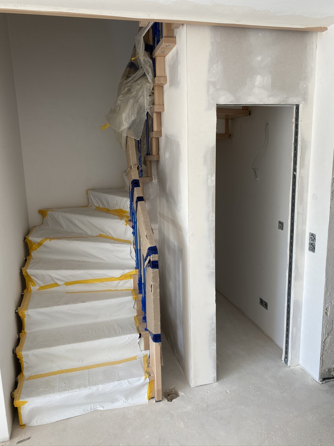

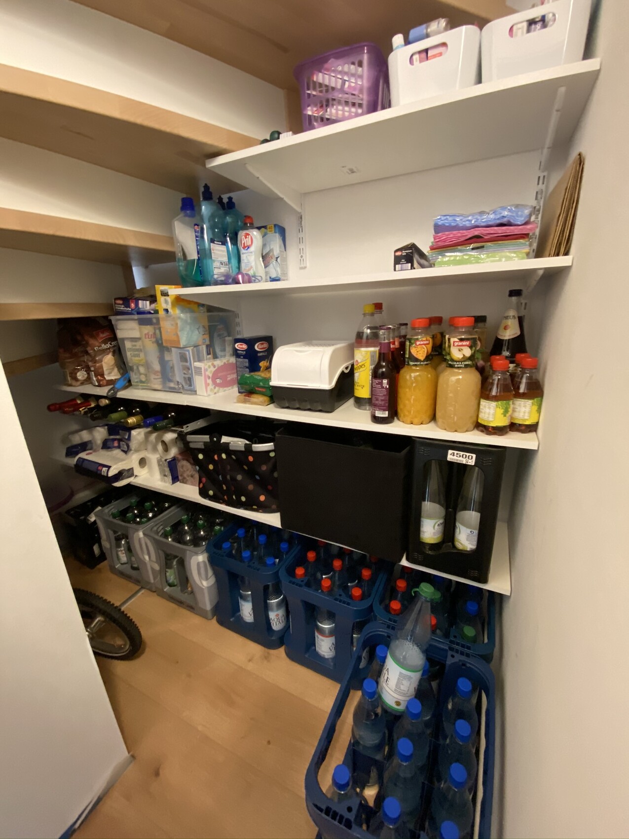

goalkeeper20 May 2022 09:03SandyBlack schrieb:
How large is your pantry under the stairs? Do you have a landing staircase?
We are also planning a pantry under the stairs, but I’m still not sure how much storage space you can actually fit in there. Here are some pictures. It was built with drywall.
It should be just under 2 square meters (about 21.5 square feet).
