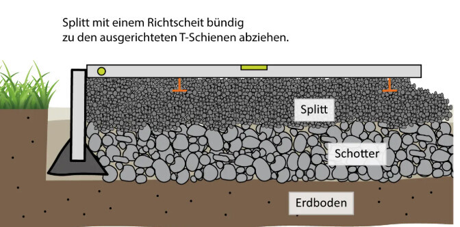

It looks like this:
MachsSelbst13 Dec 2024 23:55I hope this is not meant to be to scale. For a typical curb that a DIYer can still handle alone, with a height of 25cm (10 inches) and weighing about 34kg (75 lbs), a gravel layer of 10–15cm (4–6 inches) would be far too thin, and a crushed stone layer of the same thickness would be way too thick.
