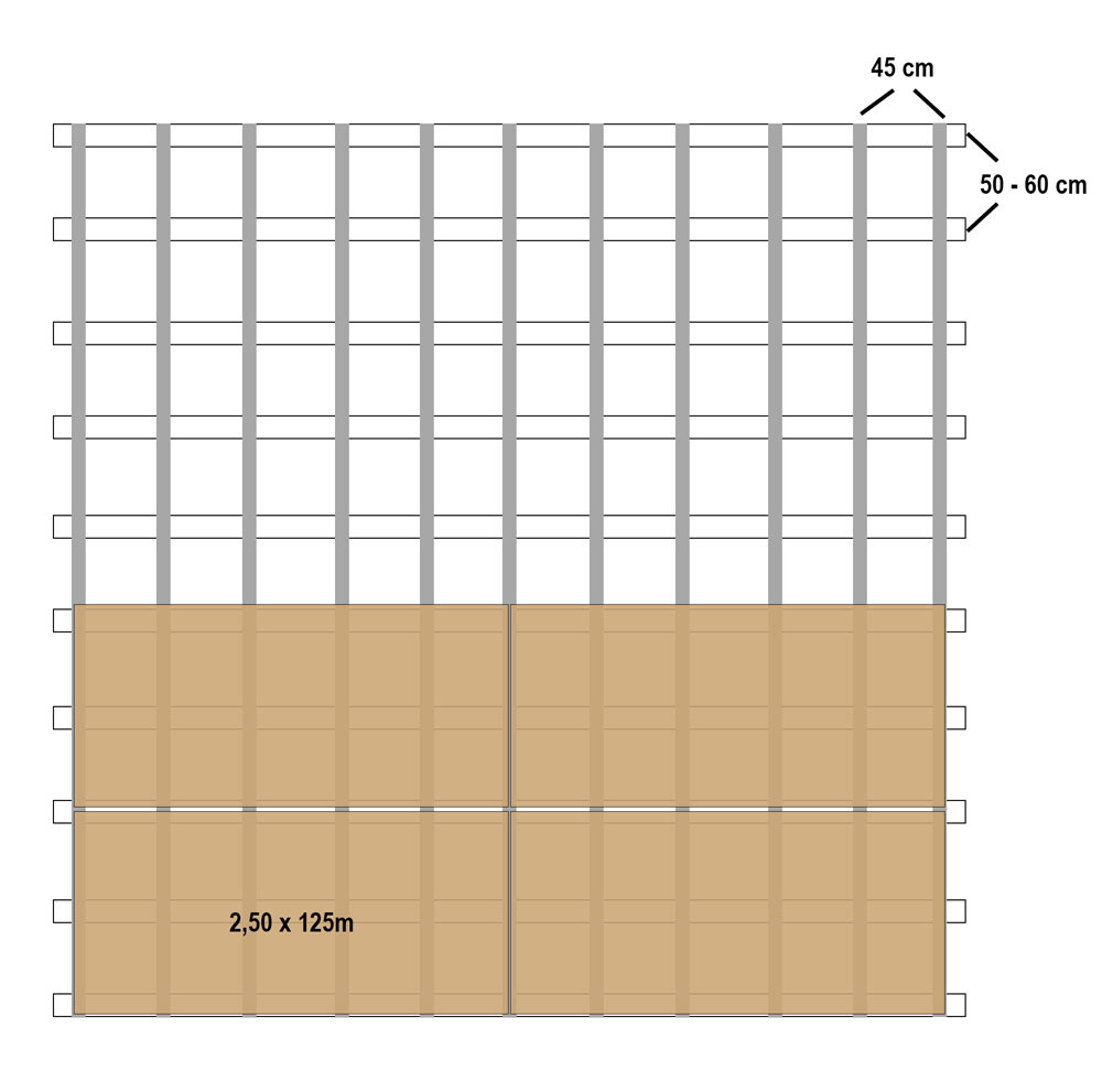

we would like to improve our single-family house from 2017 and use half of the attic as storage space.
Our roof beams are 10cm (4 inches) wide and spaced 50 to 60cm (20 to 24 inches) apart.
For the counter battens, I was thinking of using pieces measuring 60 x 35 x 200cm (24 x 14 x 79 inches) spaced at 45cm (18 inches).
For the panels, I plan to use OSB boards with a thickness of 22mm (7/8 inch) without tongue and groove, leaving a gap of 1 to 2cm (0.4 to 0.8 inch) between the boards to prevent any mold formation.
Is this setup okay so far, or is there anything else to optimize?

fach1werk21 Jan 2019 20:04After two years, we have once again laid tongue-and-groove boards in the middle section of the (hip) roof attic. The boards are installed with minimal gaps and are fixed only at one end, allowing the area underneath to move freely as needed.
Kind regards, Gabriele
