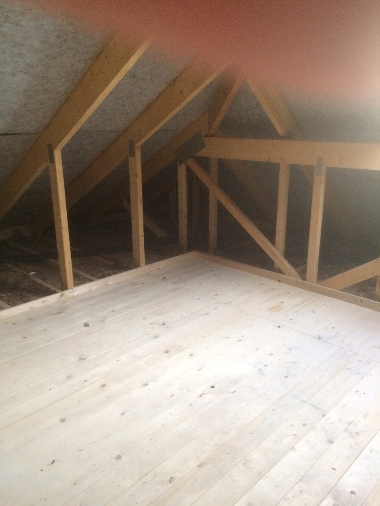

Why use counter battens? Just nail tongue-and-groove boards tightly together directly onto the joists, and you'll have a flat floor that doesn’t even allow for ventilation. That’s how our carpenter did it.
Attic with timber frame, rafters, and untreated wooden floor.
seth048721 Jan 2019 09:46
We also used tongue and groove boards. However, we built up our roof beams slightly to create some space between the beams and the insulation...
