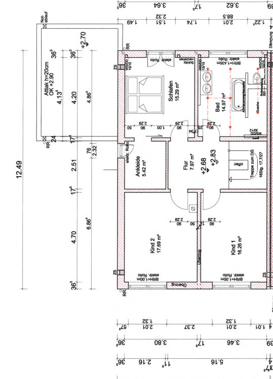

We are currently considering whether the windows in the bathroom and children’s rooms 1 and 2 are sufficient. What would you say — are they enough or should they be made a bit larger?
This is a semi-detached house.
Floor plan of a residential house with bedroom, bathroom, hallway, and children's rooms
Thank you very much for your help.

At least if the plan is oriented to north, that is sufficient. What alternatives, besides not buying this house, would be offered to you?

Certainly, the lighting in the rooms is sufficient, but not better. In a semi-detached house, at least you have a side exterior wall. Leaving it without windows is, in my opinion, a missed opportunity. Even if they are just narrow bands of windows, this usually contributes significantly to the well-being of most people in the rooms.
19 Oct 2021 20:54
Less light comes from the north than from the south!
