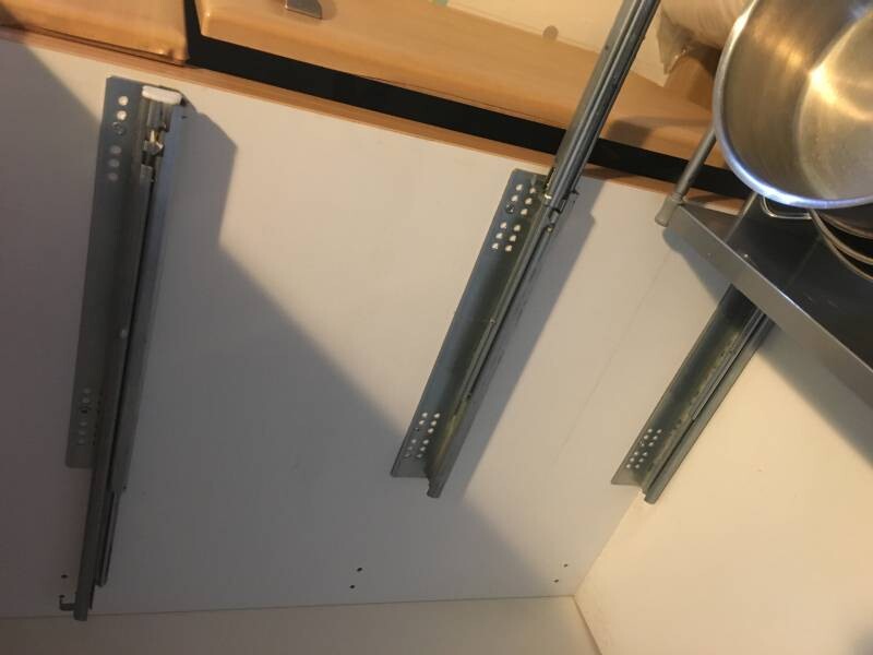

We got a used kitchen very, very cheaply, a Britta kitchen from 05/2002. It came to us after 10 years, has now been moved again, and will be expanded with three Faktum cabinets due to the cabinet body height of approximately 68–68.5 cm (27–27 inches). All cabinet doors have Blum hinges and are being retrofitted with BLUMOTION dampers at a low cost (filing oval holes into rectangular ones).
Now the drawers are up. They are Hettich Innotech drawers, manufactured according to the engraving in 03/2002. Is it possible to retrofit the old full-extension drawers with dampers? If that is not possible, can I simply switch to the current Quadro V6 with Silent System despite the age, without having to modify the cabinet sides, or is there something that doesn’t fit?
I wanted to test this just now because I bought a full-extension drawer for Faktum, but it is Rationell-B and not Rationell-H.

IKEA-Experte1 Oct 2016 15:54Hello, the RATIONELL rails definitely do not fit, regardless of whether H, B, or I. To find out if the current drawer slides from the catalog still fit, it’s best to ask Hettich directly.
