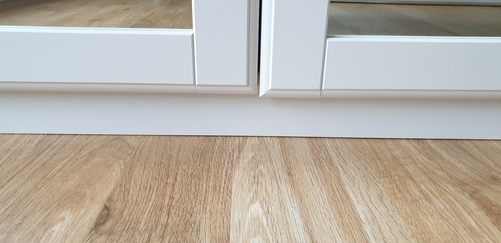

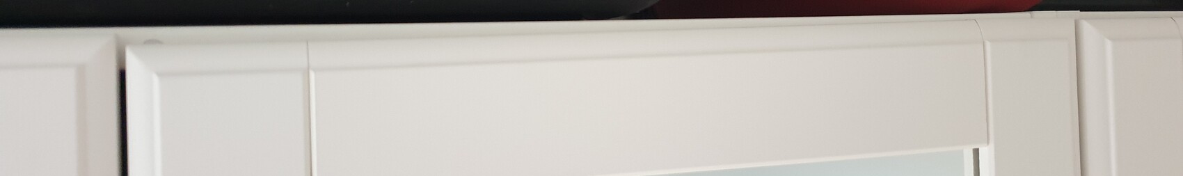

I hope you can help me. I’m having trouble aligning the IKEA Pax wardrobe, and I’m not sure if I can correct the misaligned doors using the adjustment screws.
Thanks a lot in advance
Susanne882
Bottom edge of a white wardrobe on a light wooden floor; close-up.
White wardrobe with framed doors and mirror glass below.
J
Jesse Custer
6 Jan 2025 13:00
Of course, it’s possible – you just need to adjust the screw on the hinge... usually turning it out at the top and in at the bottom.
Nida35a6 Jan 2025 14:19
If it can no longer be adjusted, placing a shim under the floor at one or two corners can help. Some floors are uneven.
