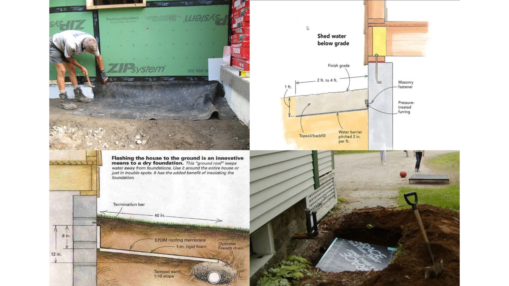

What I have heard from a few sources is that something like an underground roof or below-grade flashing can relatively easily be added later on.
If I understand correctly, this would involve installing a roughly 1-meter (3 feet) deep, 1 to 2 meters (3 to 6 feet) wide EPDM membrane around the exterior insulation, with a slope to divert water away from the outer wall and foundation.
Such a membrane including installation materials costs about 1000 euros. Compared to that, chemical injections in the basement would be significantly more expensive.
Have you heard of this kind of underground roof, and does it even make sense to do something like this?
