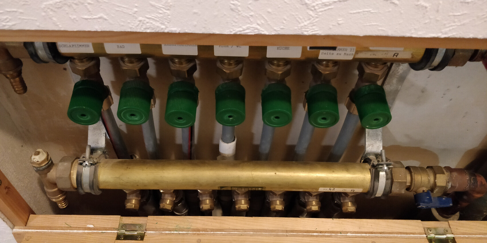

Musketier schrieb:
Maybe you should post a picture of the manual regulator; that might help. I’d be happy to do that once I’m “over there” again. I’m still sitting in the old apartment right now.
The parts look roughly like in this picture. Unfortunately, behind the picture there’s only a message saying "The classified ad is no longer available," and there’s no larger version of the image.
Below that is a thermostat valve with an M30x1.5 thread, like those on a standard radiator, only here it’s on the heating circuit manifold for the underfloor heating. However, I can’t use a regular radiator thermostat head because it would open or close depending on the temperature inside the wall box where the regulators are located. Instead, I need a thermostat knob that statically controls the flow.
For now, I just want a simple, pragmatic solution to get through the winter and then take a closer look at the entire heating system next year.
