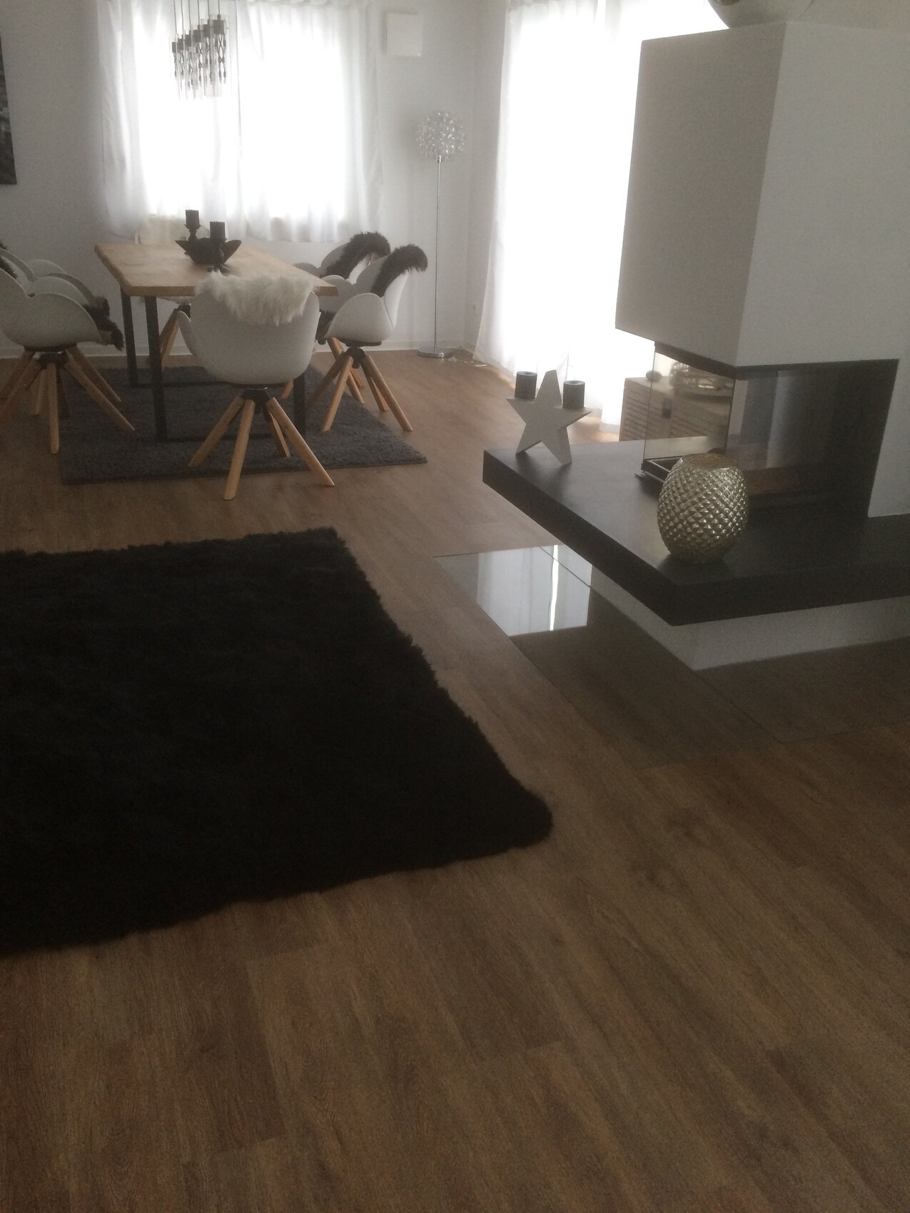

@Hexe 1717: Throughout the entire house, we have fully glued vinyl flooring, see example image. It was not cold underfoot when we moved in in August, rather neutral, and is now very comfortable in winter. It looks like wood and somehow feels like it too. So far, we have only used a maximum of 27°C (81°F) supply temperature in the underfloor heating, with an outside temperature of -6°C (21°F). The floor is neither too warm nor too cold. It cost €49 per square meter (approximately $49 per square yard) including installation. We would do it exactly the same way again.
