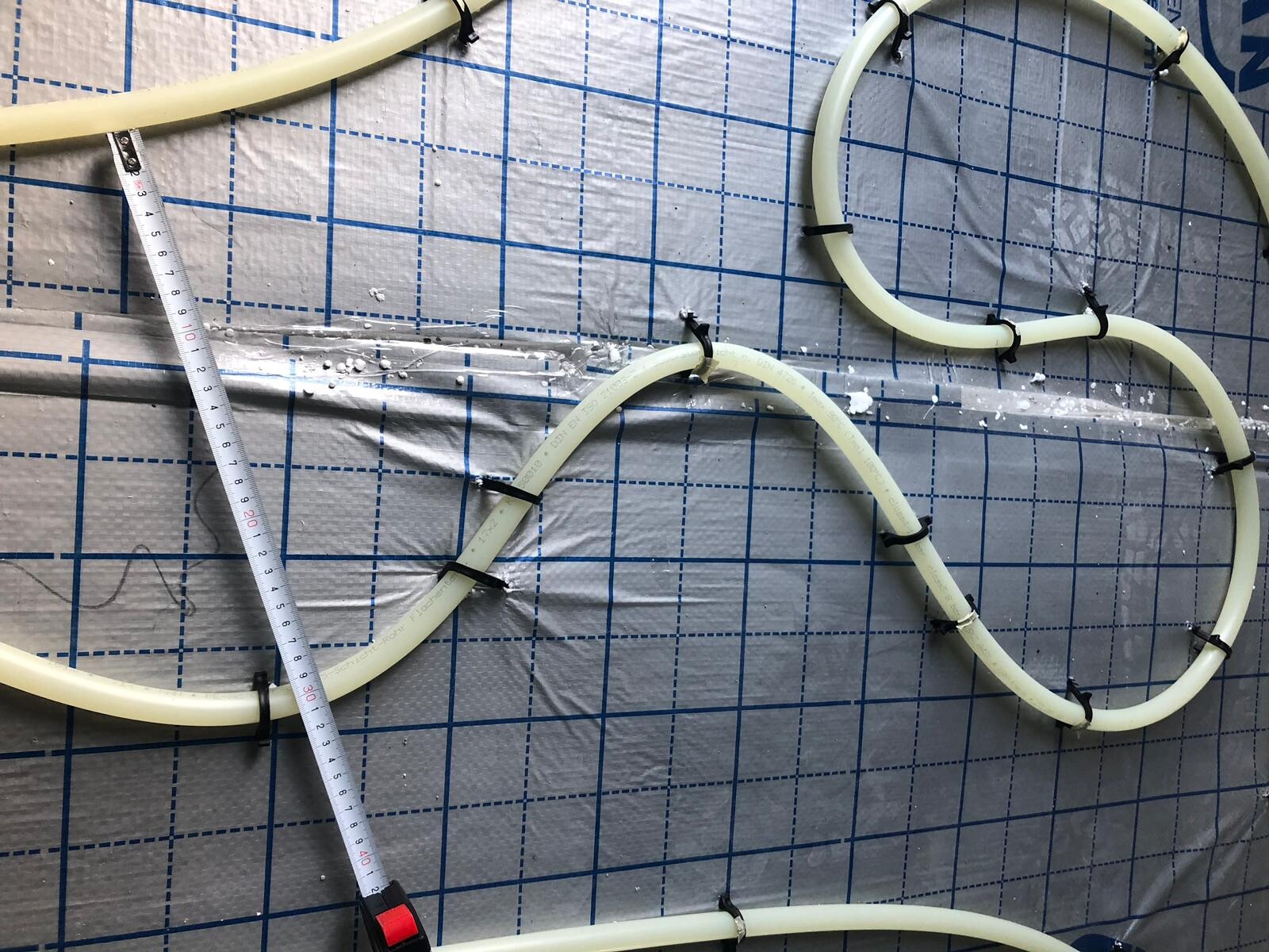

1) What should be the maximum spacing between the underfloor heating pipes? Some sections seem quite far apart, around 30cm (12 inches) to me.

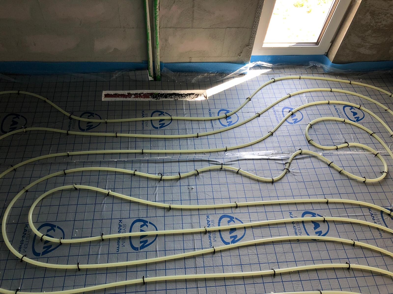

2) Is it common to leave some areas without pipes? (Like the spot in front of the bathtub, see picture)

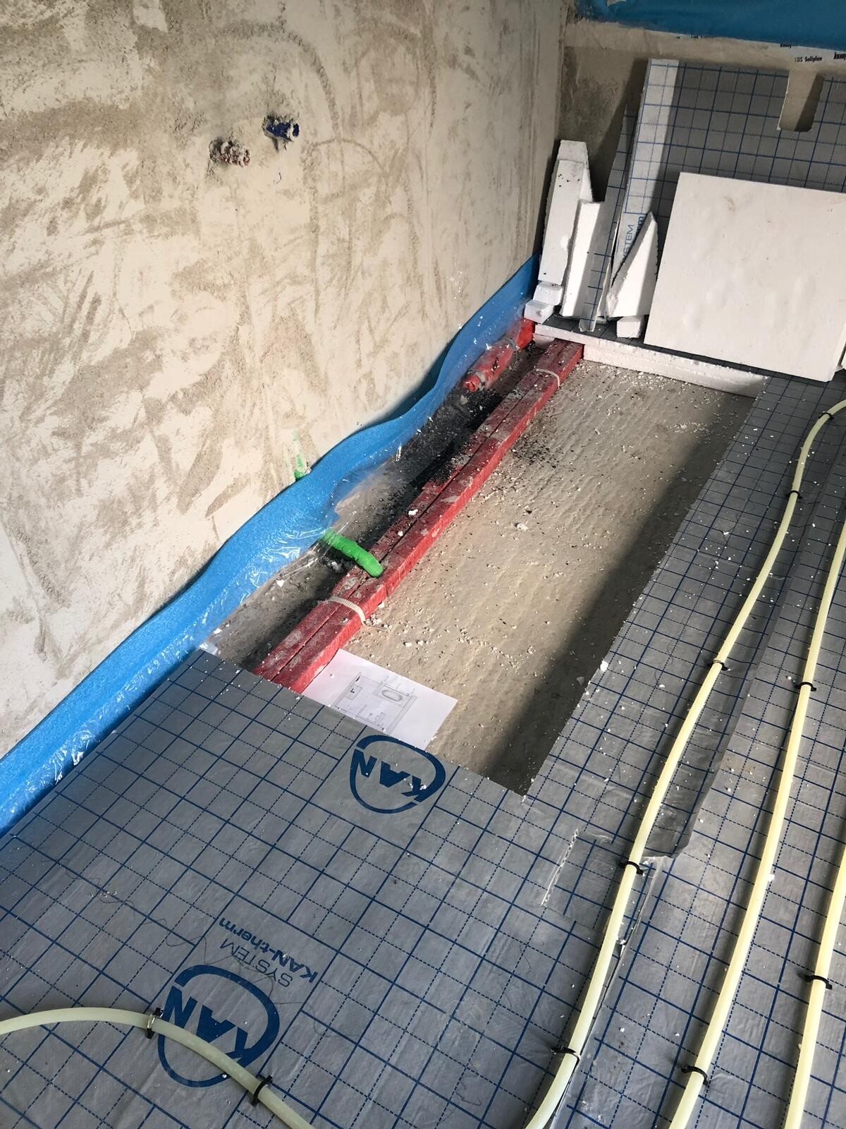

3) Now that I removed the styrofoam around the bathtub, there are still some pipes underneath. Don’t they cause any issues? And why is such unstable styrofoam even placed between the floor and the screed?
