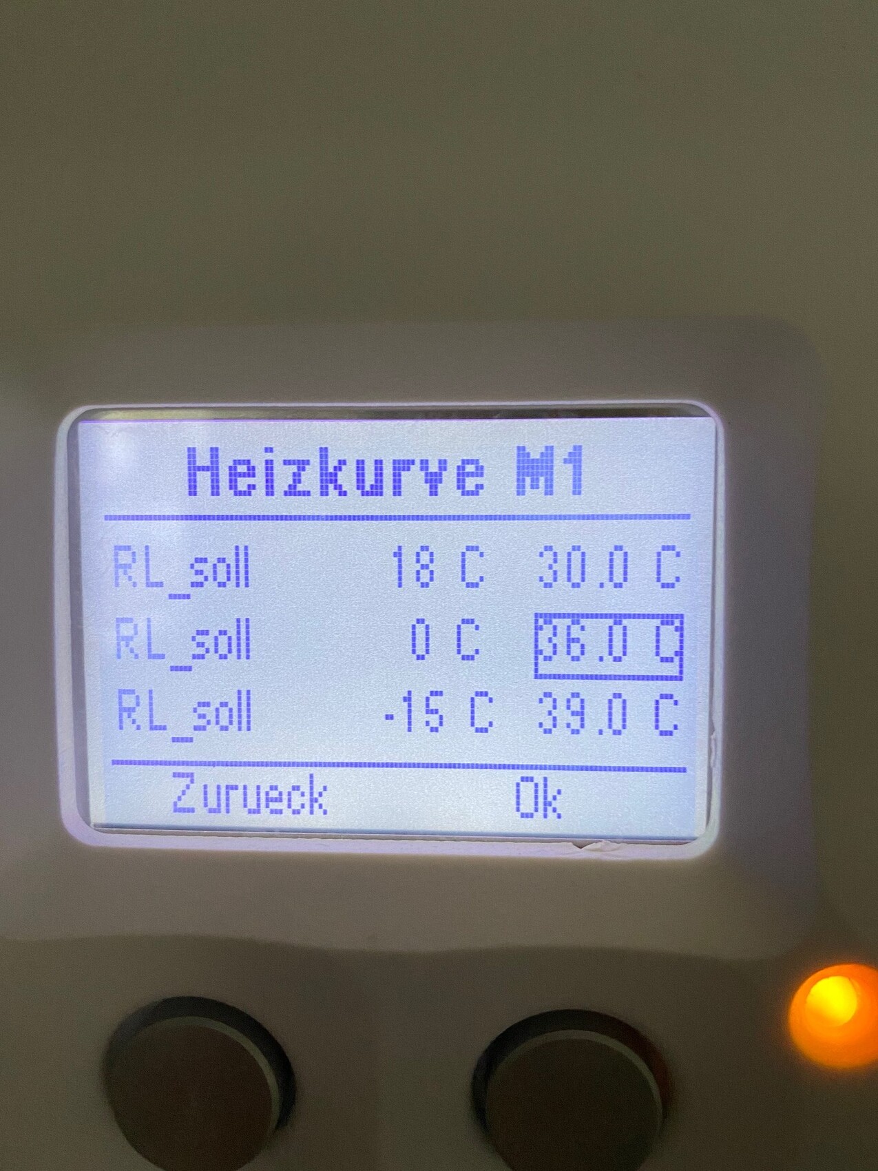

I currently have the following settings for the heating curve:
Here is the heating curve of the mixing valve:
I haven’t done a hydraulic balancing yet.
The heating limit is set to 14°C (57°F) and for the mixing valve to 18°C (64°F).
Do both heating curves need to have the same values?Those are quite high values!
